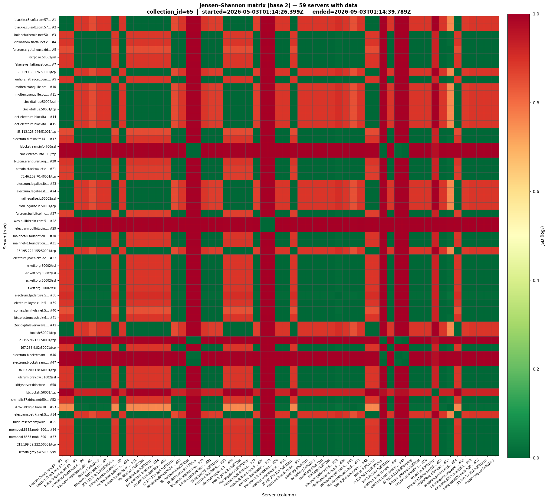

Figure below shows a matrix comparing all servers against each other at a specific moment in time.
Initially, I expected to observe most pairs with high divergence values (closer to 1). However, the opposite happened. Most server pairs had JSD = 0, meaning their fee histograms were identical.
To better understand this behavior, I used JSD as a clustering metric. Using a simple rule where servers with JSD <= 0.5 are considered connected, I generated 5 clusters.
Cluster 1 is particularly interesting because it appears to group servers from apparently unrelated organizations and operators.

These clusters have remained stable since the beginning of the collection. Sampling different timestamps shows that many of these servers continue exposing identical histograms over time.
This is obviously not evidence of a Sybil or surveillance infrastructure by itself, but it is still a curious result.
Right now, I am investigating how different Electrum server implementations generate the get_fee_histogram response. The protocol documentation does not clearly specify how histogram bins should be constructed, so what I am observing may simply be an implementation artifact.
As the next step, I plan to incorporate additional metrics suggested by b10c in the original research idea and verify whether these clusters remain stable across multiple independent signals.
