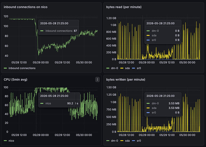

As part of my peer.observer Bitcoin node monitoring infrastructure I’m running a v29.3.knots20260508 Knots node with the name nico.

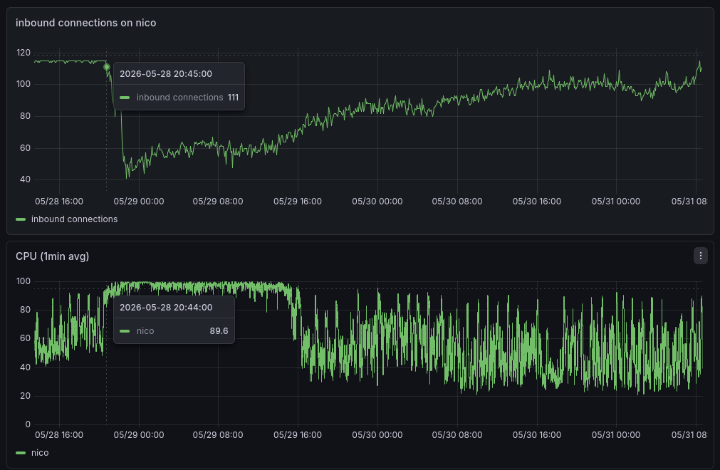

I noticed that on 2026-05-28 at around 20:30 UTC the inbound connections this node had started to drop. At the same time, the CPU usage increased.
edit: to be clear: all other nodes were fine during this period, but this doesn’t mean this is a problem specific to Knots - it could also be a problem caused by parts of the codebase that’s shared between the projects. At the moment, I run (and pay for) one Knots node for monitoring.

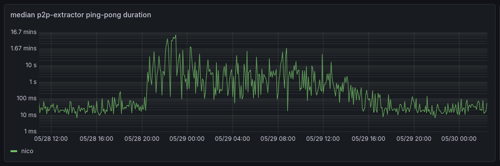

At the same time, the localhost Bitcoin Protocol ping-pong duration on this node increased, which is usually a sign that the node isn’t able to keep up with message processing. This will cause connections to drop after a while.

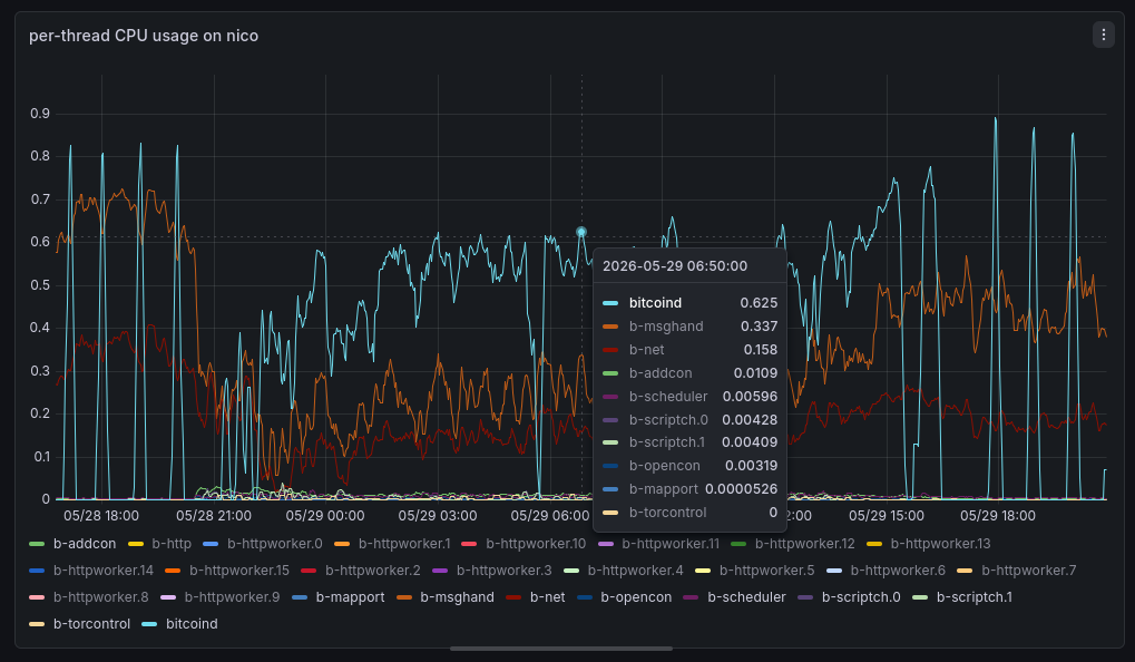

Interestingly, the CPU usage of the net and msghand threads dropped (likely due to fewer peers) and a while later (the first time at 21:15 UTC), the bitcoind thread usage increased and stayed elevated for a while. This is different behavior from e.g. Bitcoin Core :: Disclosure of DoS due to inv-to-send sets growing too large, where the CPU usage was in msghand.

There seem to have been elevated, but not high, disk reads and writes during the high CPU usage. The spikes in disk io before and after the high CPU usage are likely leveldb disk compactions.
The bitcoind (unnamed) thread does handle leveldb compaction.
