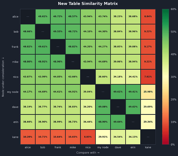

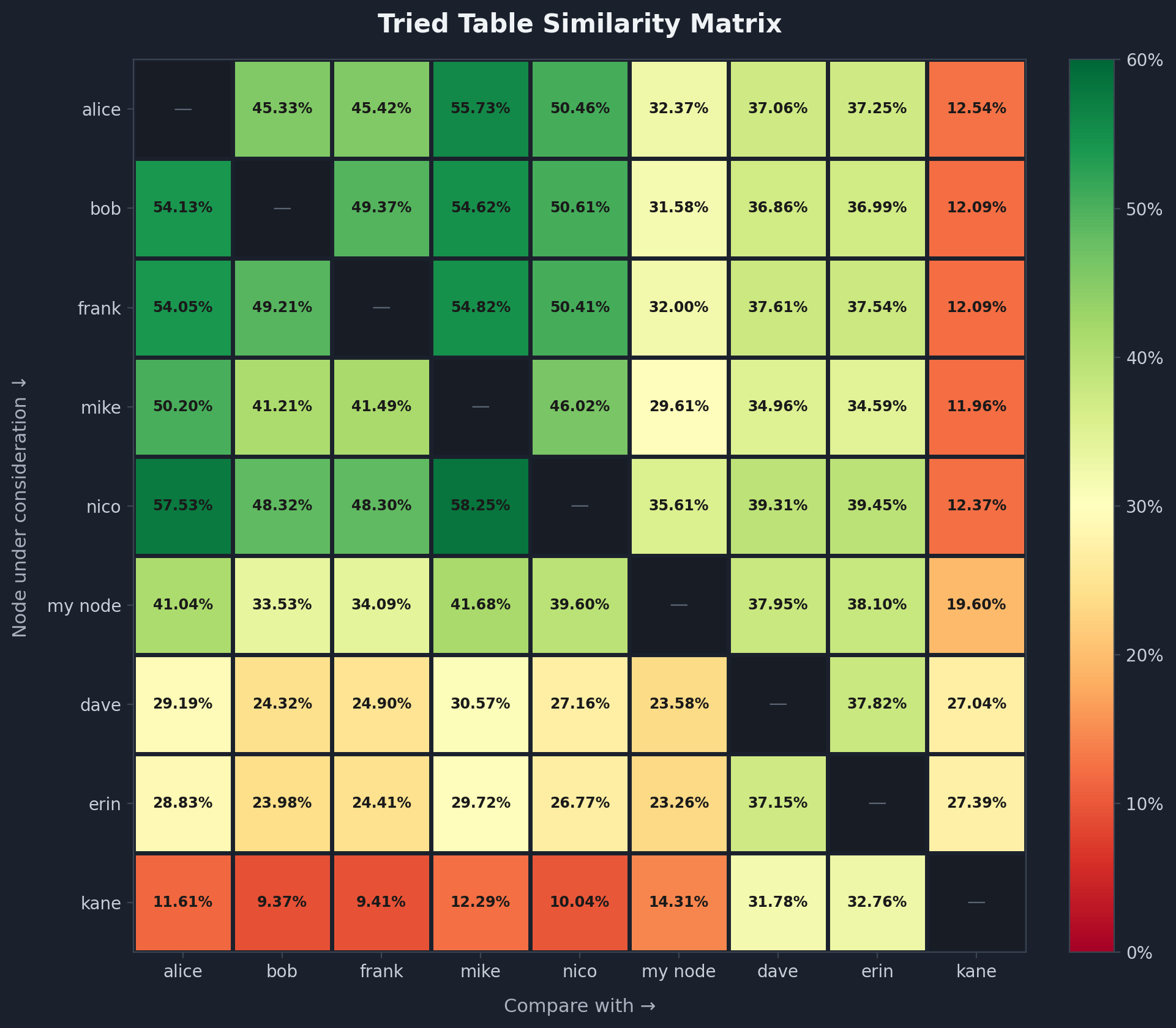

I think your comparision matrixes could also be plotted as a heatmap with matplotib/seaborn and have a color showing higher/lower similarities.
I was going to comment the same thing, it would be way better to visualize. So to add to this post, I asked to claude to do it as it’s a simple thing, the hard work was already done by @stratospher :slight_smile: .
1. new table similarity
2. tried table similarity
wow so pretty! it looks so much better than just numbers! thanks @m4ycon! and thanks @b10c for the idea!

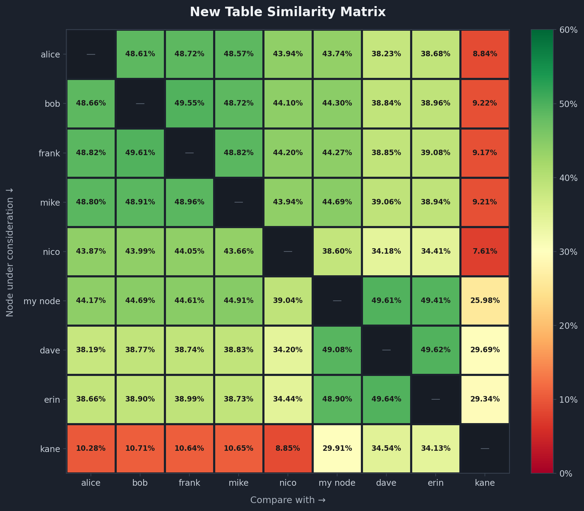

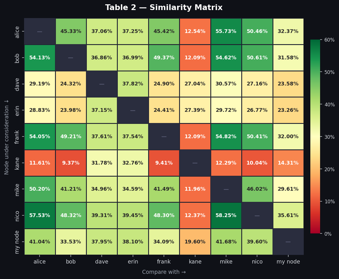

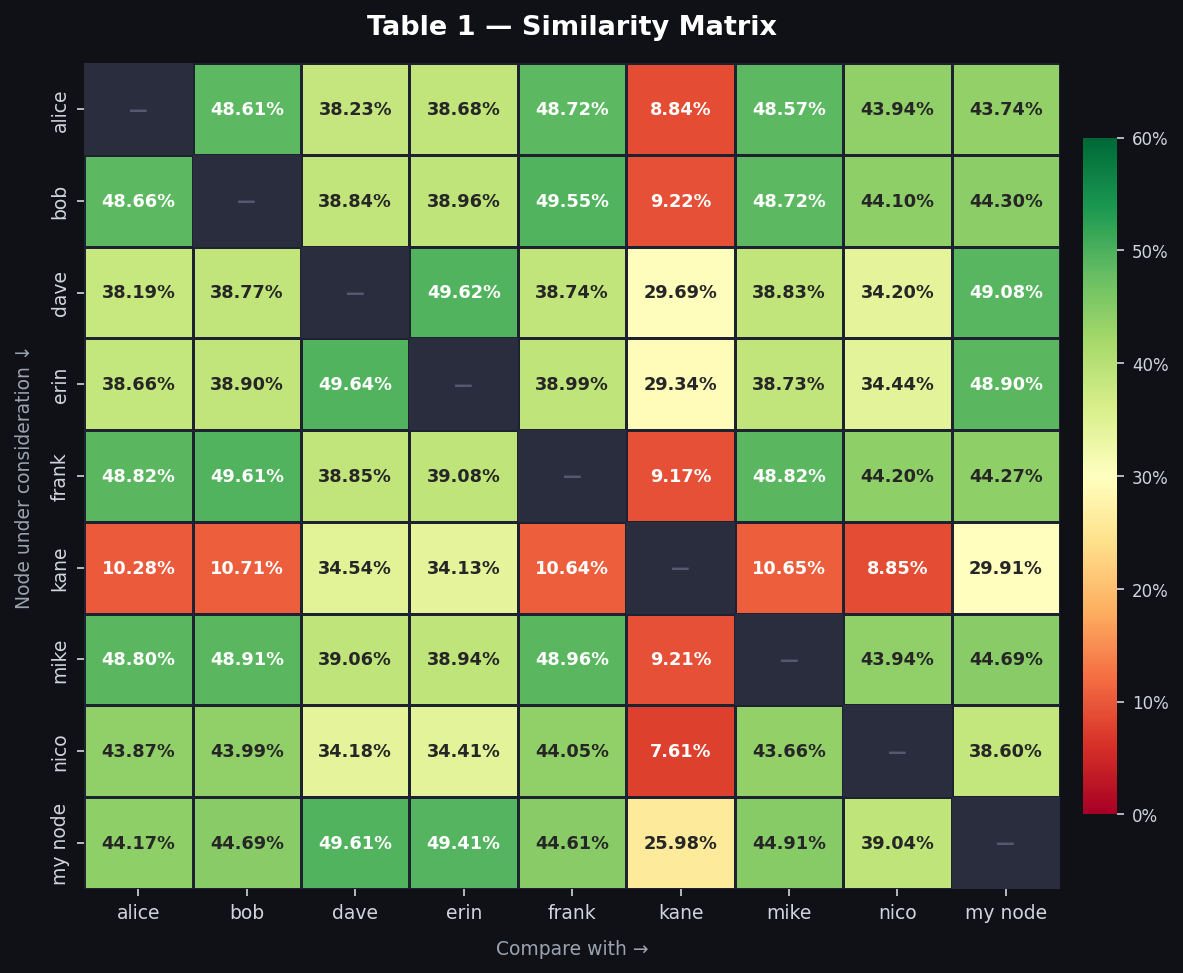

I also wanted to reorder the rows and columns so that the similarity degradation can hopefully be seen better.
  • alice, bob, frank, mike, nico - clearnet
  • my node - clearnet + onion
  • dave, erin - clearnet + onion + i2p
  • kane - onion + i2p
basically “alice, bob, frank, mike, nico, my node, dave, erin, kane” as the row + column headers instead of current order.
EDIT: so I asked claude to make heat map as well! it didn’t look nice at all - so shared @m4ycon’s great colours and aesthetics.
but I’m not able to edit the original post and replace the numbers with the nice heatmaps and maybe remove more numbers.
