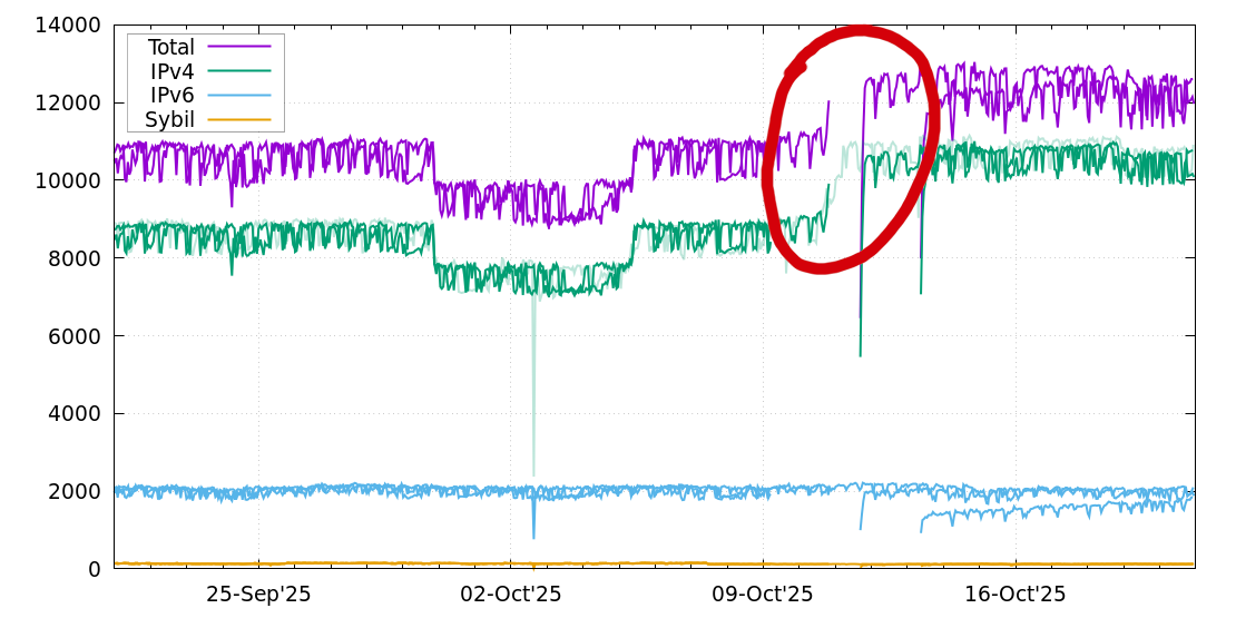

A few days ago, a sudden increase in the number of reachable IPv4 nodes from about 8,500 to 10,500 was observed by our monitoring nodes at KIT:
This increase seems to come mostly from 2040 new reachable addresses in the autonomous systems 12029 and 29798. From each of these ASes, we see 1020 IP addresses distributed over four /24 subnets:
AS 12029:
45.40.98.0/24
103.47.56.0/24
173.46.87.0/24
206.206.109.0/24
AS 29798:
89.106.27.0/24
174.140.231.0/24
184.174.95.0/24
216.107.135.0/24
According to whois data, these ASes are owned by TenSpire Network / bitprojects.io (see /Satoshi:29.1.0(dont-spam-me-bro)/ nodes?)

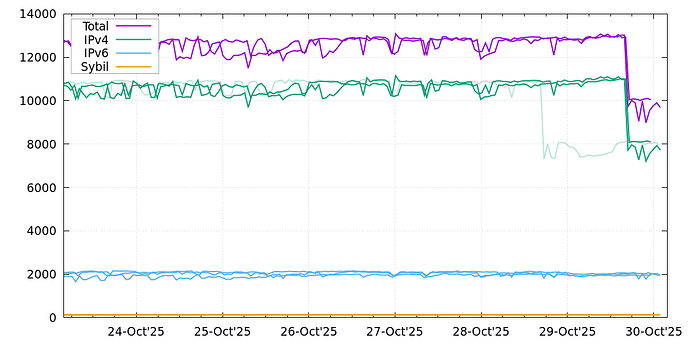

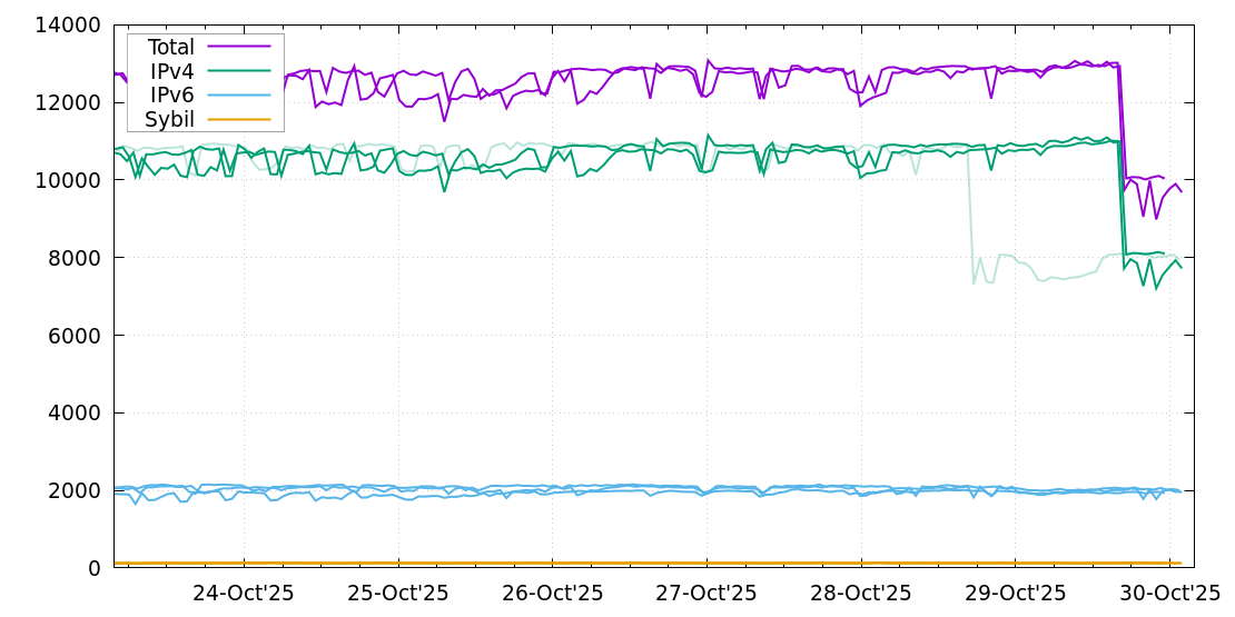

Since yesterday, the addresses from the three mentioned ASes appear to be offline from the view of our monitors. However, I’m not sure whether they are actually offline or just blocking connections from our peers because one of our monitor nodes lost the connections to those peers about 24 hours earlier than the other two monitor nodes.
Interesting! I noticed already last Friday (2025-10-24) that I didn’t have any open connections to “dont-spam-me-bro” nodes anymore. But they seems to just have changed their user-agent at around 3am UTC on that day.

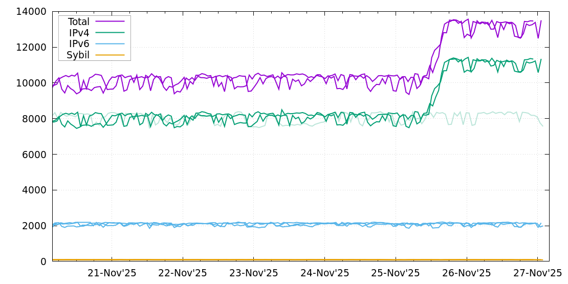

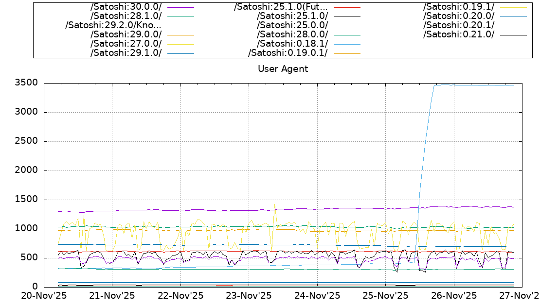

About 3000 nodes are back. Now, they have the user agent /Satoshi:29.2.0/Knots:20251110/.
I think you are right. The person running bitprojects indicated that there is some automatic blocking of connections and specifically mentioned the KIT monitors to be affected by this.
