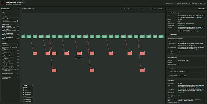

Following up on my earlier thread about recovering pre-2015 Bitcoin stale blocks from merged-mined chains (here), I kept pulling on that line of work and have created a new tool in service of the Bitcoin monitoring mission: the Merge Mining Monitor.
As in the original post, Stifter et al. showed that merge-mined child chains preserve the Bitcoin parent headers their miners actually hashed. That makes them a side channel into Bitcoin stale and orphan blocks, as well as a way to associate child-chain blocks with the Bitcoin parent headers they committed to.

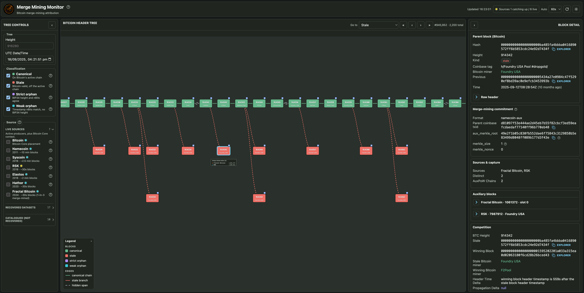

What began as a historical data recovery exercise turned into a live and historical monitor (I did things a bit backwards compared with the original plan, at least in terms of publishing the datasets etc.). The monitor reads AuxPoW evidence across six live producers, 17 recovered child-chain datasets, and ten catalogued chains where data is still missing. It then makes the resulting pool attribution, child-chain attribution, stale-block evidence, and orphan evidence explorable in a fork-observer-like tree view.
The current record is 2,200+ recovered stale & orphan blocks from current chain tip right back to 2011 when Namecoin started merge-mining with Bitcoin. Many of those blocks have no durable trace left on the Bitcoin network itself.
Even though direct Bitcoin-network monitoring is much more mature in 2026, the value of this side channel is still apparent. For example, the monitor recovered an F2Pool stale at Bitcoin height 953,715 via RSK, around two weeks ago at time of writing, which does not appear to have propagated widely on the Bitcoin network: F2Pool 953715 on RSK. There are many such instances, with this just being the most recent.
