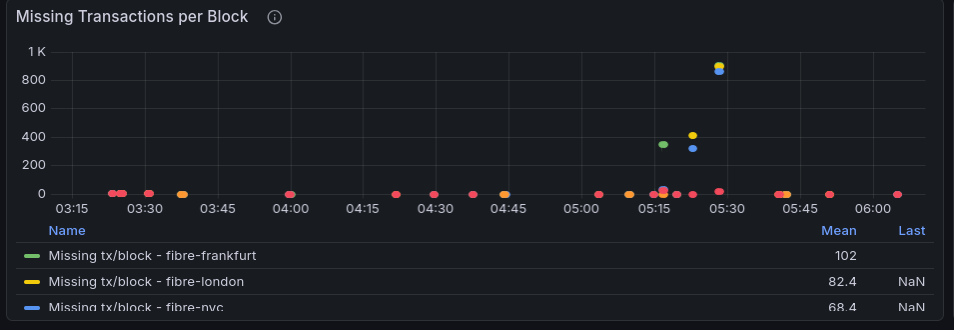

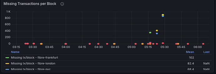

I had lost the link to the “stats on compact block construction”, that is the one that gives me most food for thought for p2poolv2. Even if we still reward the uncle blocks p2poov2, we still want to reduce uncles. The catch is we need to pay RTT cost to get missing transactions from compact blocks. The stats data from delving shows a much higher number of misses than I expected.
My conclusion is we need to watch this like a hawk on p2poolv2. We’ll have to have good tracing and emit tracing data to prom/grafana to watch these misses - something like on FIBRE’s new dash Grafana
