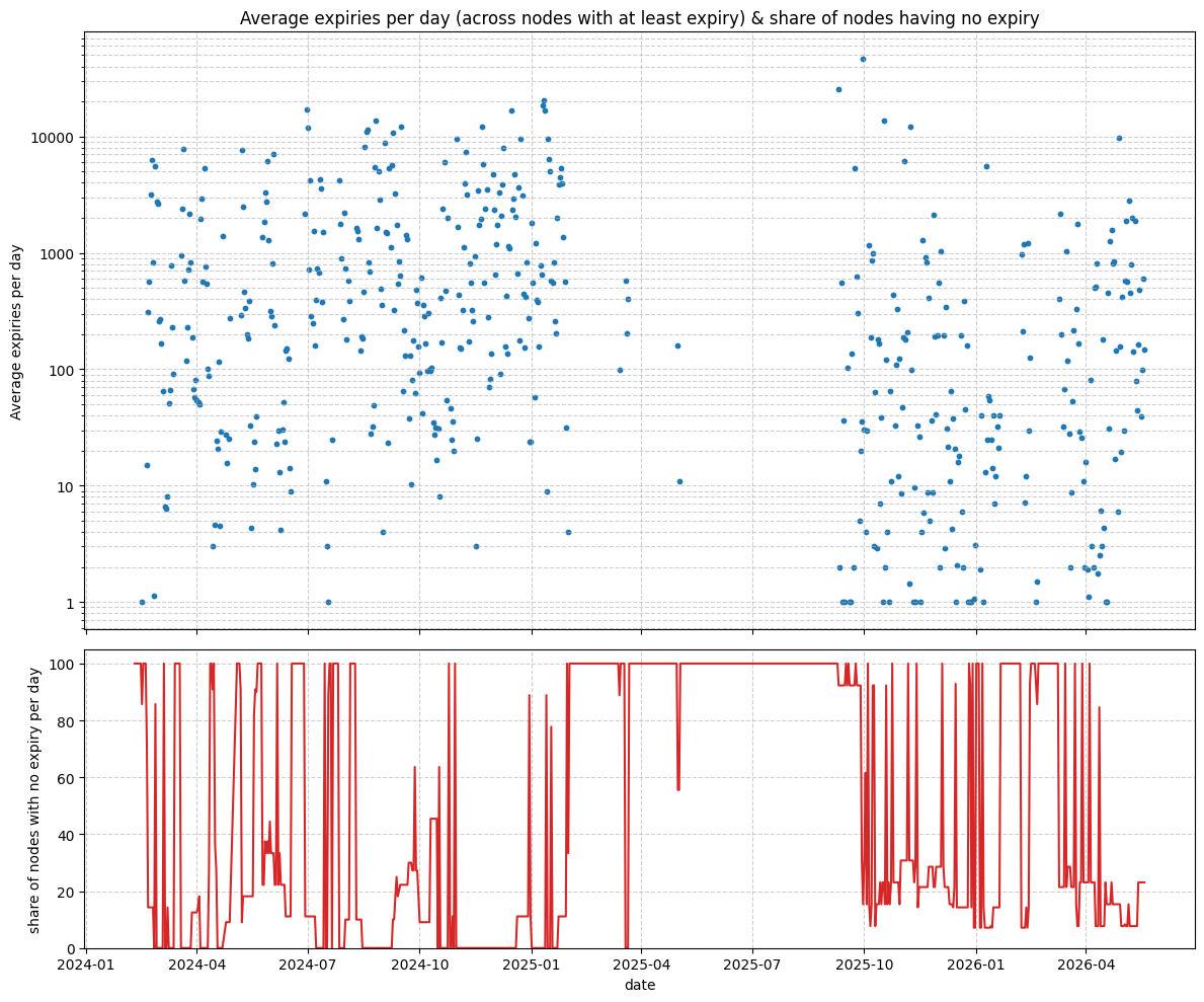

Would a graph with time-based evictions per day be helpful? Do you need raw data?
I think a graph would be great! I am just trying to get a gut-feel for how often this may occur.
I noticed that we log two lines for each expiring transaction, so just grepping for a reason=expiry will yield two log entries for each transaction that expires.
[validation] Enqueuing TransactionRemovedFromMempool ... reason=expiry
[validation] TransactionRemovedFromMempool ... reason=expiry
While analyzing the data, it took me a while to find something that conveys what I’m seeing: The upper part shows the average number of expiries per day on the nodes that saw at least one expiry on that day. This is usually somewhere between 10 and 10k. There are also days without any expiries. This is shown in the bottom part of the chart: when it reaches 100%, all nodes didn’t see an expiry.
I was surprised to see only very few days between 2025-02-01 and 2025-09-15 with expires. I see the other obvious mempool removal reasons on these dates (block, conflict, …) but no reason=expiry.

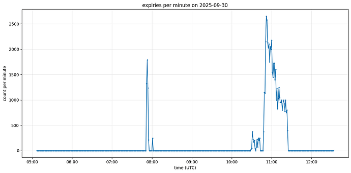

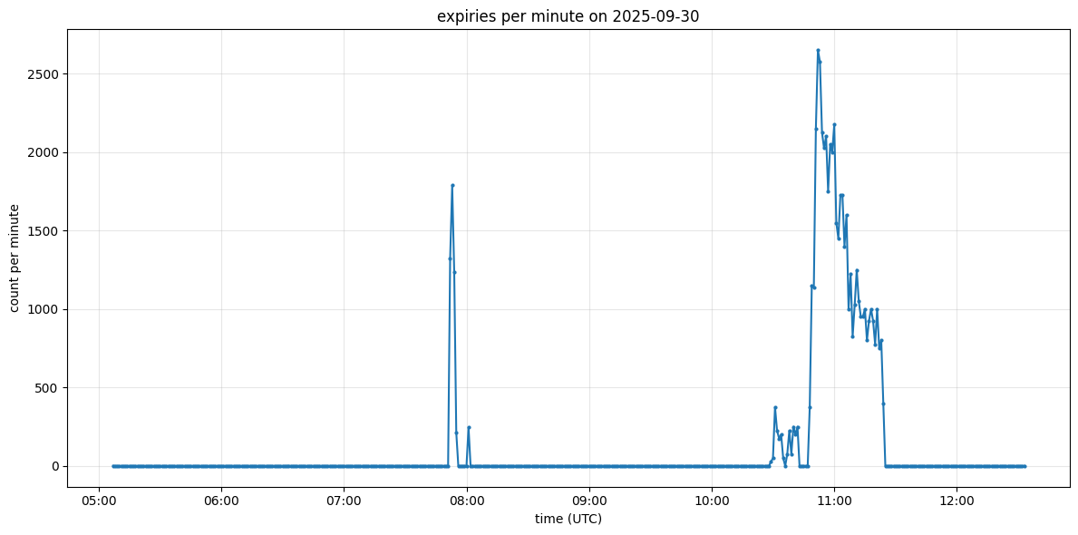

The most transaction expires per day in my data, with roughly 57k expired, happened on 2025-09-30. These expired in two batches:
  1. a smaller batch at around 8:00 am UTC
  2. a larger batch at around 11:00 am UTC
I manually looked up some of the txids of the two batches:
  1. small batch at 8am
  1. larger batch 11am:
For both batches, all transactions I looked at were eventually mined. So either someone rebroadcast them, or pools kept them around. The first batch transactions all seem to reveal an inscription and have a runestone OP_RETURN. The second batch all seem to have a OP_RETURN runestone, but don’t reveal an inscription.
I was wondering if these transactions were rebroadcast or if the miners still had them. We don’t know for sure what the miners did, but grepping for the txids show that they all were re-added to my mempool on 2025-10-03.
