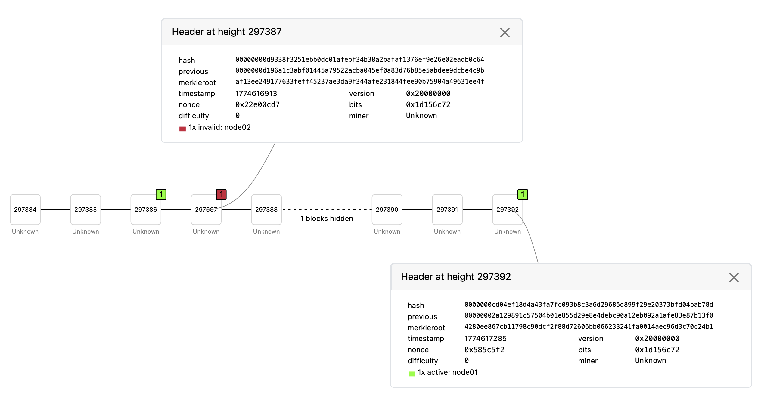

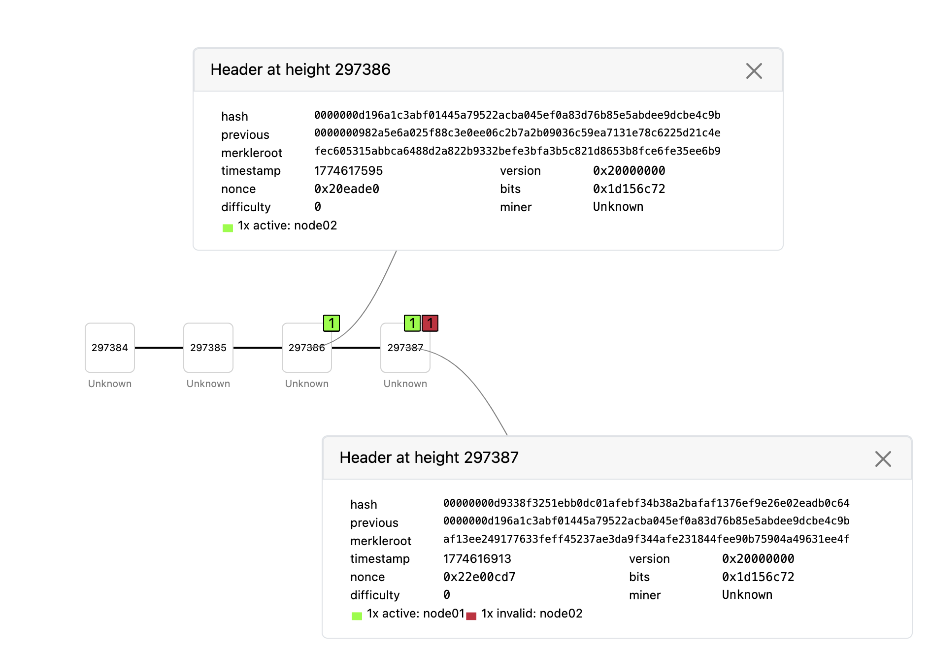

I have an invalid block on the Inquisition v29.2 node
2026-03-27T13:16:00Z
The Bitcoin Core v31.0rc1 node is struggeling a bit to validate the blocks. This one took just over a minute to validate:

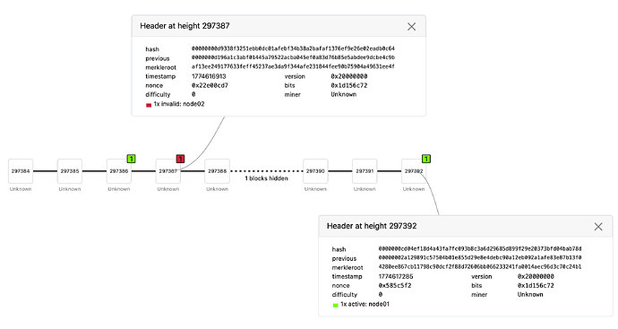

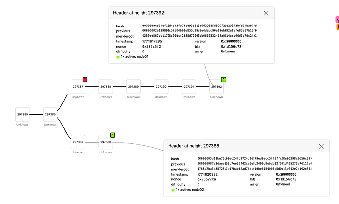

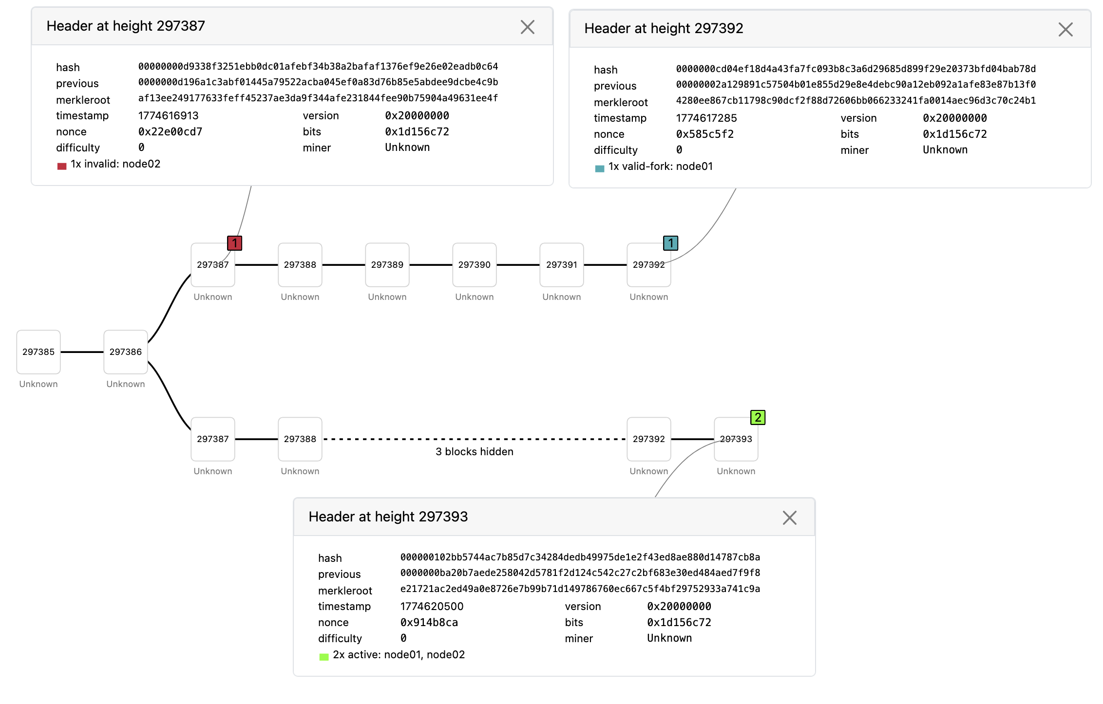

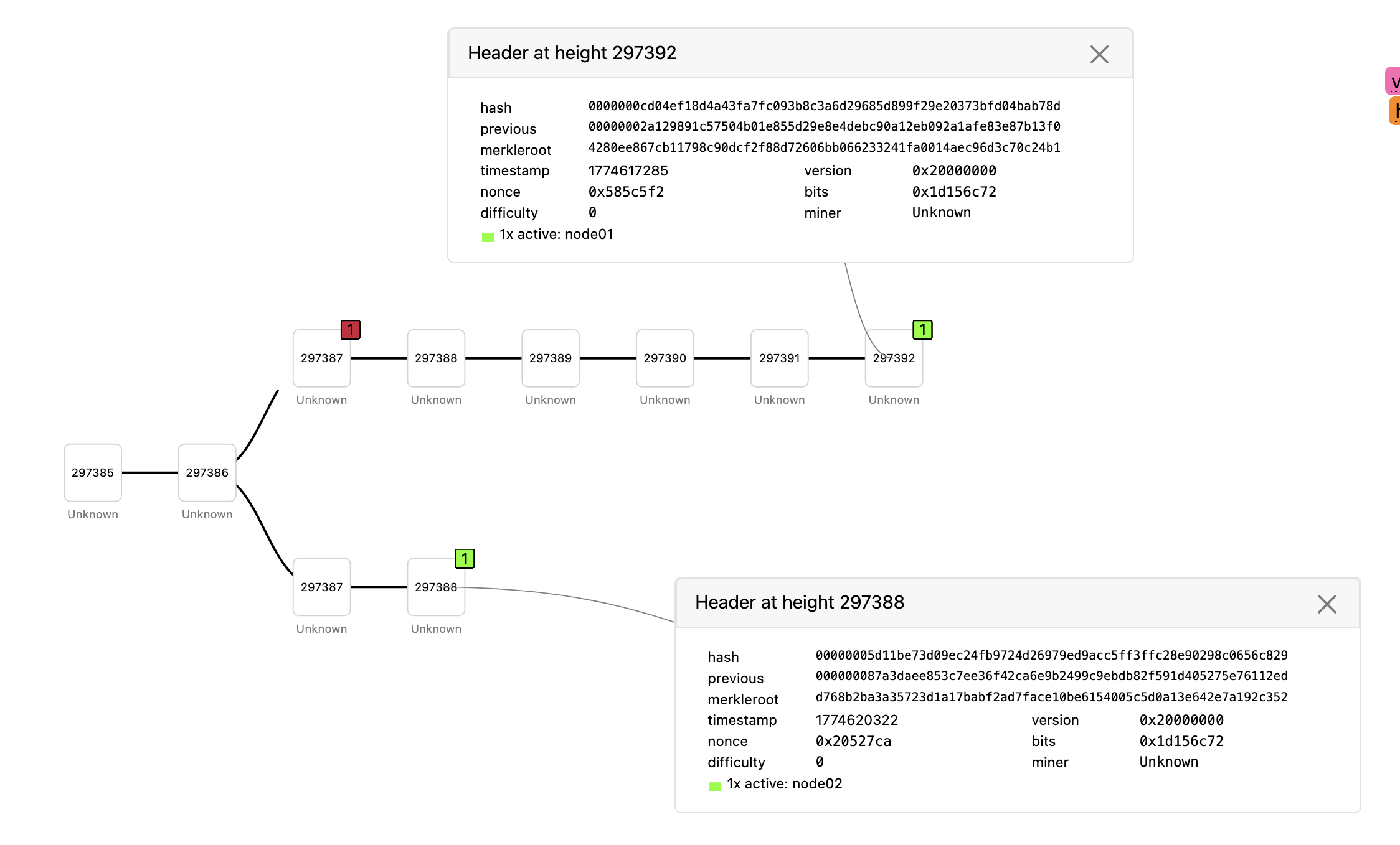

2026-03-27T13:22:00Z
The Bitcoin Core node is now at 297392, while the Inquisition one is still at 297387.

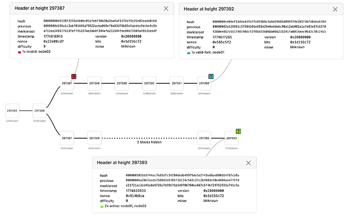

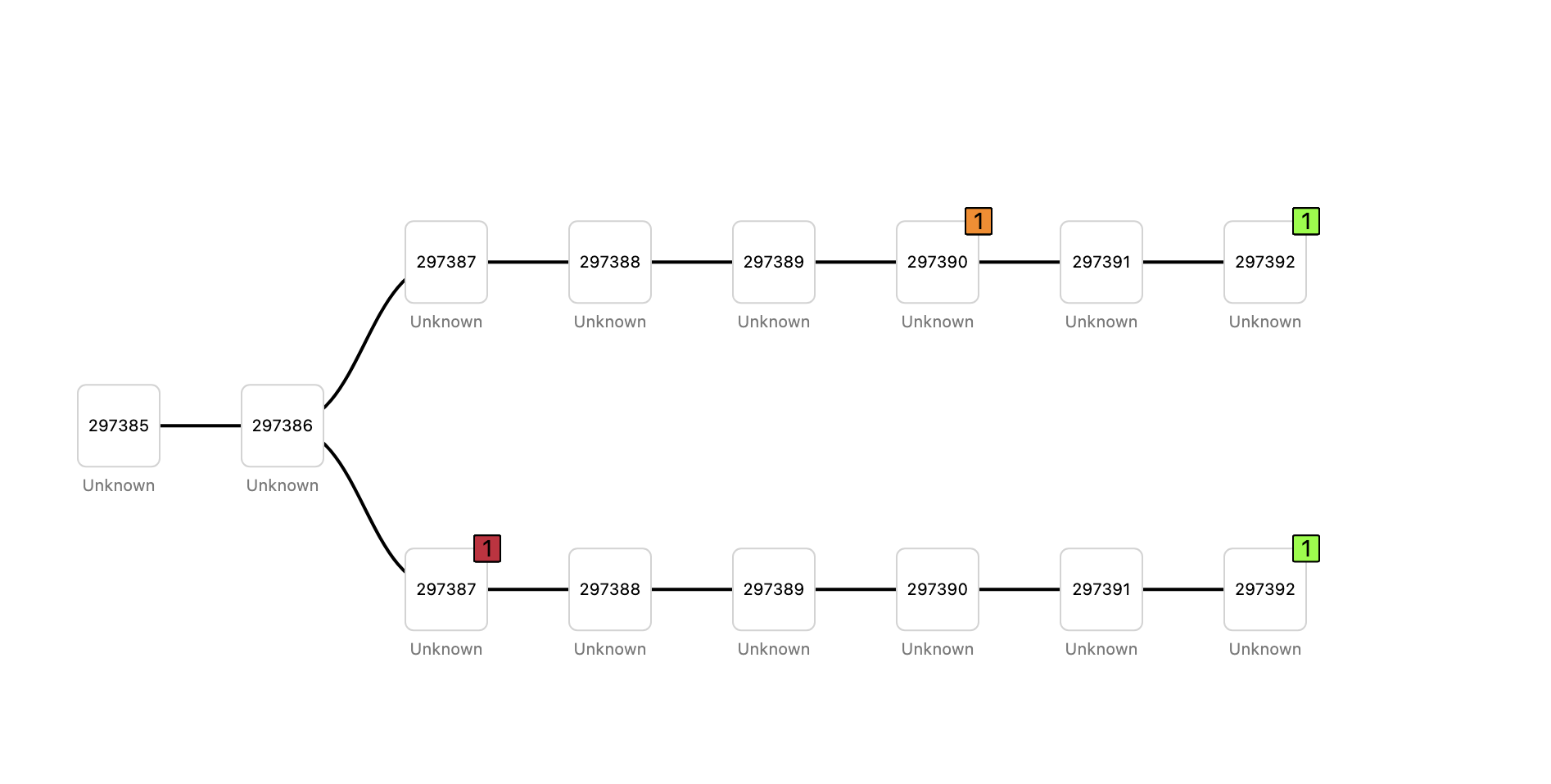

2026-03-27T13:26:00Z
We have started to reorg.
2026-03-27T14:03:00Z
We are about to reorg.
2026-03-27T14:10:00Z
And we have reorged.

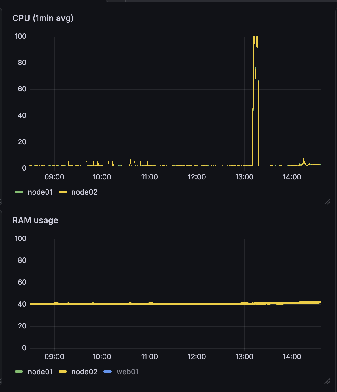

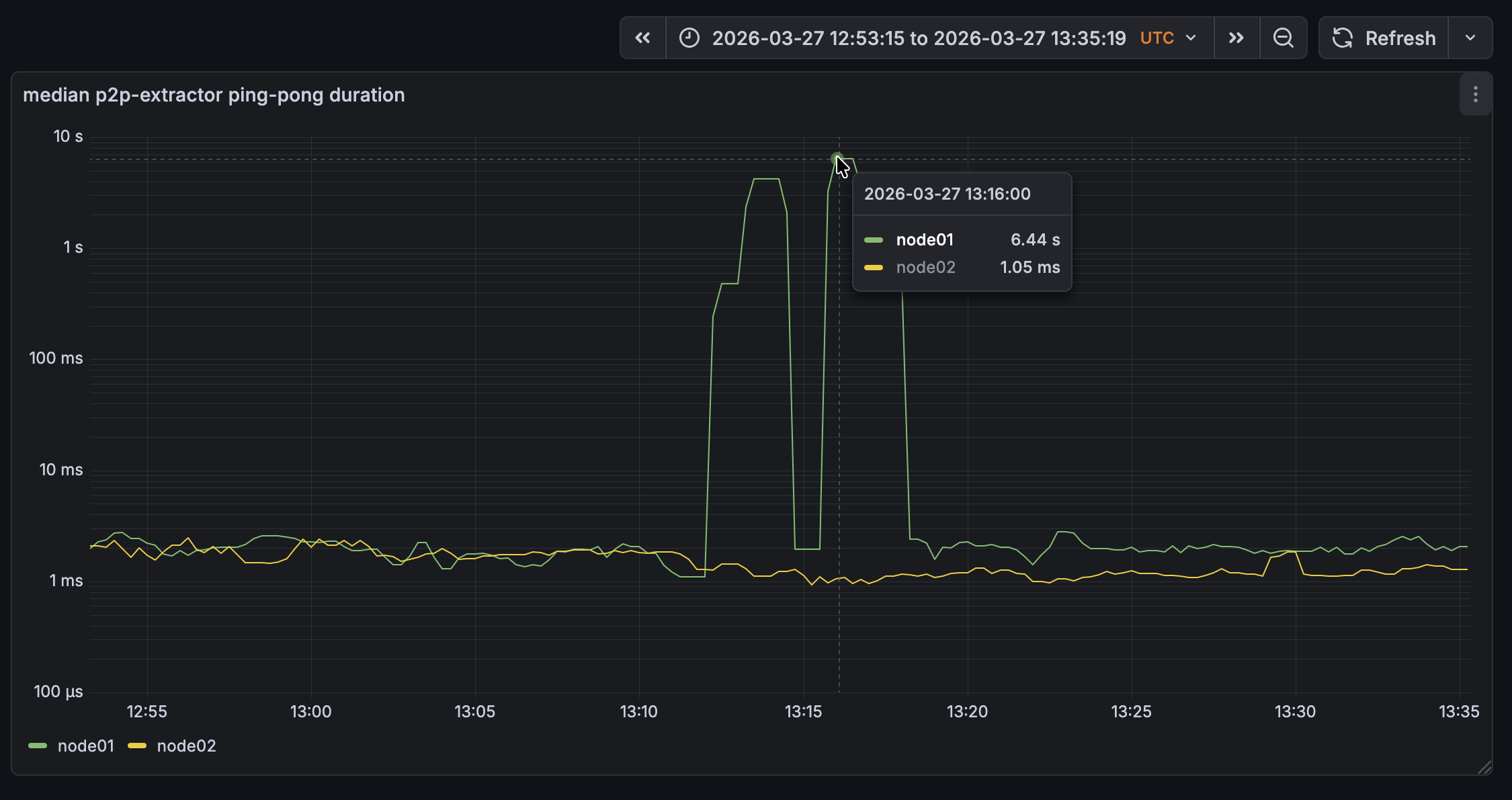

The median ping time to the Bitcoin Core node spiked:

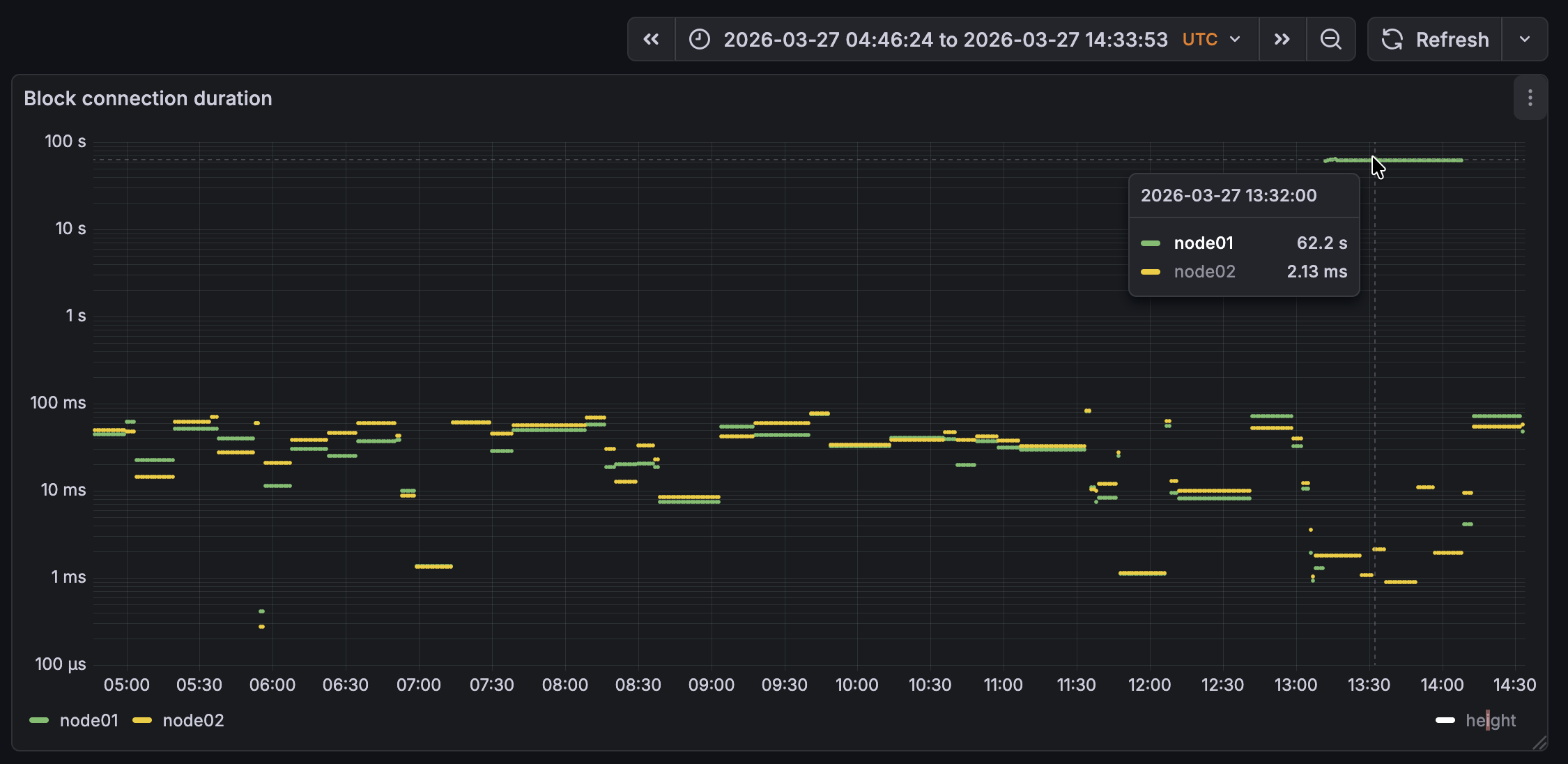

And the block connection time of the Bitcoin Core node shows a similar story to the logs:
RAM usage remained flat, but CPU spiked:

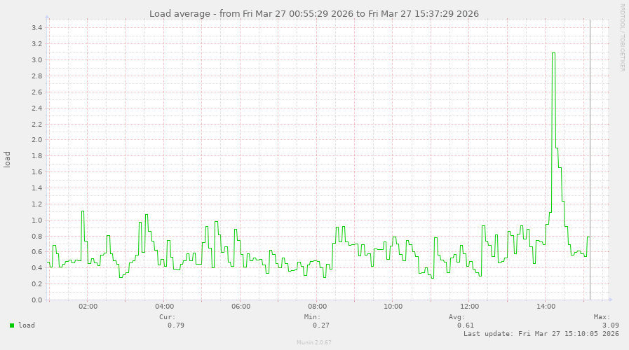

Also saw a load spike on the 6 cores Intel(R) Core™ i7-8700 CPU:
