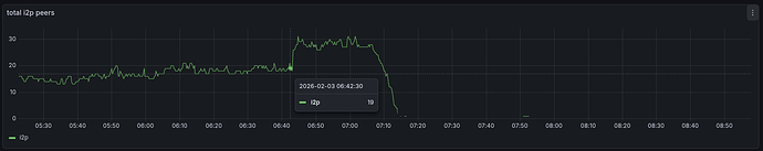

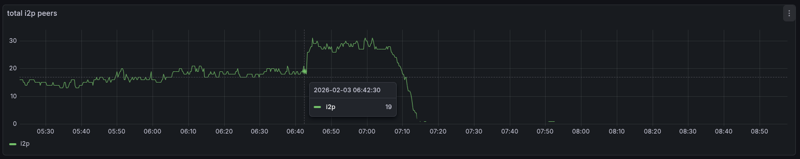

There’s an Ongoing Attack on I2P Network Causing Degraded Performance that’s also affecting Bitcoin node connectivity via I2P. I run four Bitcoin nodes with I2P connectivity, and all seem to be affected.

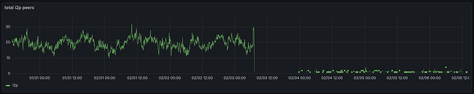

My monitoring indicates it started on 2026-02-03 at around 7 am UTC when all my nodes lost its peers that were connected via I2P. Since then, connectivity seems to have been close to non-existent.
Interestingly, the number of total I2P peers I had jumped from 19 to 29 right before connectivity stopped.

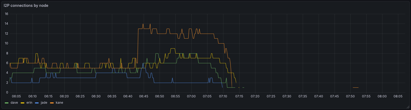

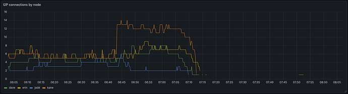

Splitting it up by node shows that node kane, which is only connected via Tor and I2P, saw the biggest increase in I2P peers.
This is pure speculation. I don’t actually know how I2P works in detail:
One idea I had why kane saw more I2P connections shortly before I saw the attack on my nodes was: Other nodes were affected first. So their I2P connections went down and they started to look for a new connection. Since they could still reach me, my I2P connections increased.
