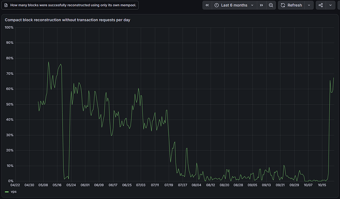

The degradation

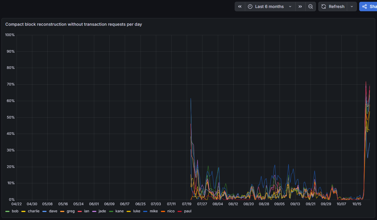

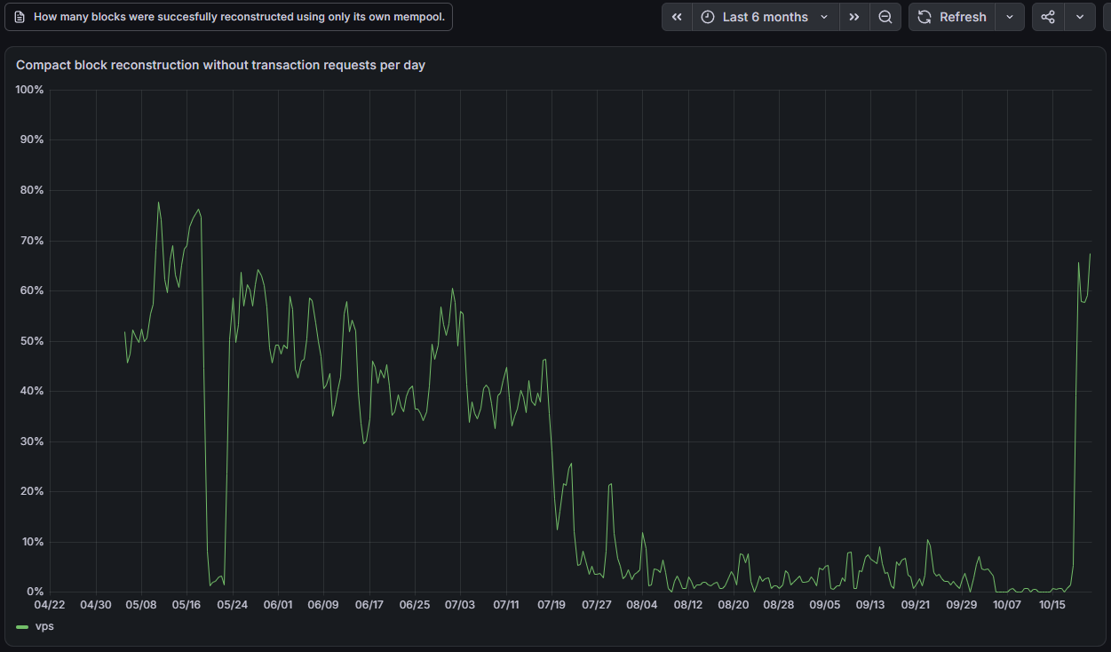

The below image shows how much reconstructions requested zero transactions from the sender, based on the previous log. Higher is better.
It shows a clear degradation in this metric from 2026-07-18 to 2026-10-18, from around 35~60% to at most 10% inside the period. This can be also seen in b10c’s nodes as the below image shows, see delving#1052 tables for a longer period.
What does it mean for the network? More roundtrips happening in reconstructions, so more getblocktxn being sent from nodes when (ideally) it shouldn’t happen – among other problems of network.

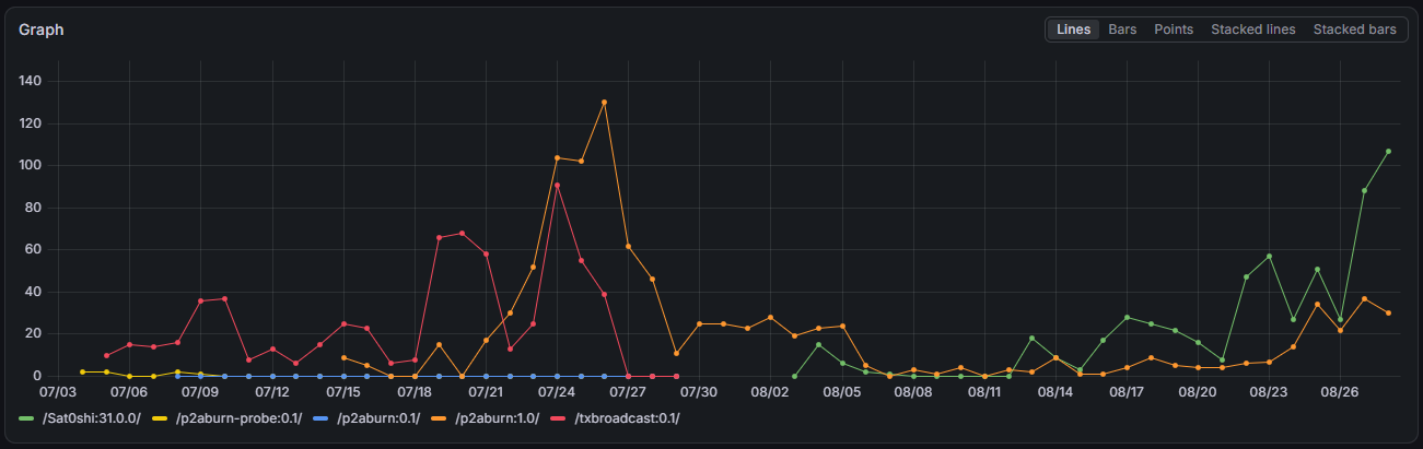

After reading #193, I took some time investigating those strange agents: /Sat0shi:31.0.0/ and /Satoshi:31.0.0/ with protocol version 70015. I also found another agent behaving similarly /p2aburn.*/, that was also mentioned later in the same post. Later, I found /txbroadcast.*/ which also behaves similarly to those peers.
The moment those nodes first appear seems to correlate with the degradation start and they make sense to impact on this. As mentioned by the author, and also seen on my node, they were sending many unsolicited transactions to our nodes.

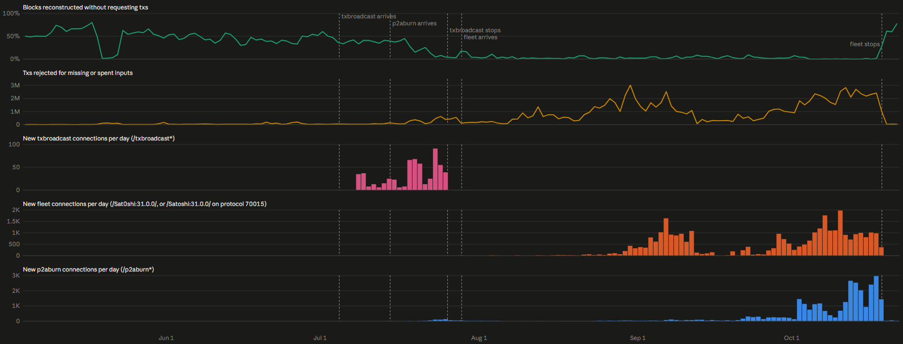

At #193 comment, I built a first timeline with each event, but here it is a more updated version:
Notes:
  • The bar panels are based on logs and they go from now until 2026-07-08.
  • The query used for the peer-observer data (line panels) is sum by (useragent) (increase(peerobserver_p2p_version_useragent{useragent=~"/txbroadcast.*|/p2aburn.*|/Sat0shi:31.0.0/"}[1d])). Also, it doesn’t mean that they held X connections on that day.
  • There’s no way to filter Satoshi:31.0.0 70015 in peer-observer data, but they appear on the panel based on logs.
Timeline:

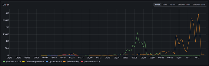

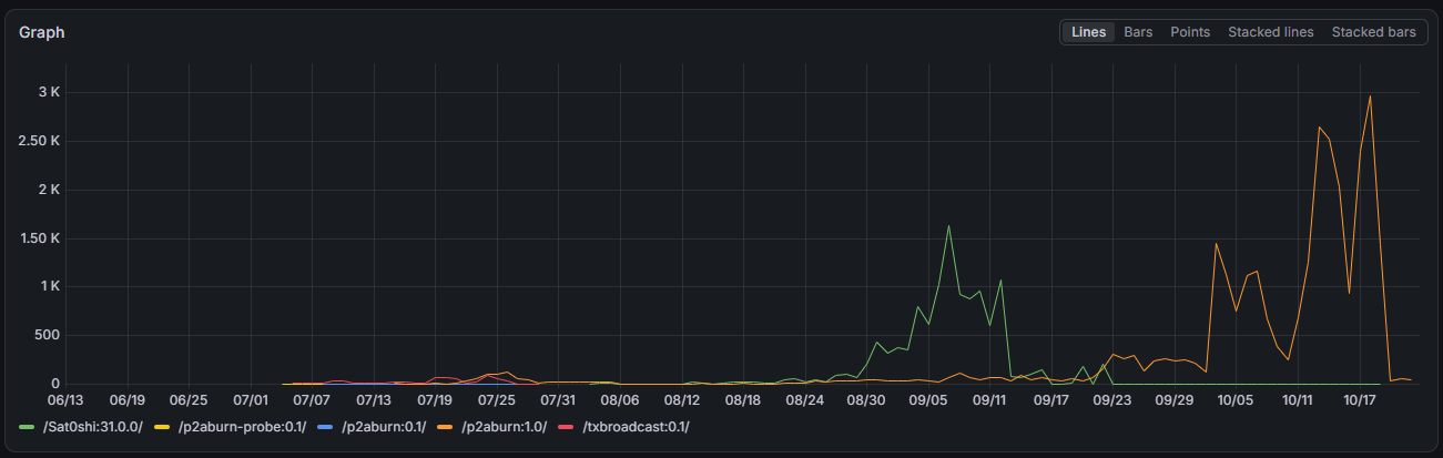

  1. 2026-07-03: /p2aburn-probe:0.1/ first appearance;
  2. 2026-07-04: /txbroadcast:0.1/ first appearance;
  3. 2026-07-07: a single /p2aburn:0.1/ connection;
  4. 2026-07-14: /p2aburn:1.0/ first appearance;
  5. 2026-07-18: compact block reconstruction degradation starts (below 10% from 2026-07-23);
  6. 2026-07-25: /txbroadcast:0.1/ last appearance;
  7. 2026-07-28: /Sat0shi:31.0.0/ first appearance;
  8. 2026-09-21: /Satoshi:31.0.0/ (protocol 70015) first appearance;
  9. 2026-09-22: /Sat0shi:31.0.0/ last appearance;
  10. 2026-10-18: /Satoshi:31.0.0/ (protocol 70015) last appearance;
  11. 2026-10-18: compact block reconstruction degradation stops;
  12. 2026-10-19: after some peaks, /p2aburn:1.0/ falls to about 30~50 connections per day and a very low volume of messages.

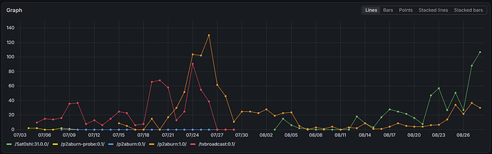

At the same time that /p2aburn:1.0/ arrived and started sending a meaningful volume of messages, the metric started declining. And just recently, since many VPS providers rebooted their machines due to CVE-2026-99999 (including mine), see more at #189, this metric bumped to the usual 40~60%. This may have another reasons, but at the moment is my only clue on why they’ve stopped.
Note: from now on, I will call /txbroadcast:0.1/, /Sat0shi:31.0.0/ and /Satoshi:31.0.0/ (protocol 70015) set as the “fleet” – because their behavior are similar, unlike /p2aburn.*/.
Currently, we have zero connections to the fleet and just a few /p2aburn.*/ active, but sending a way lower volume of messages.

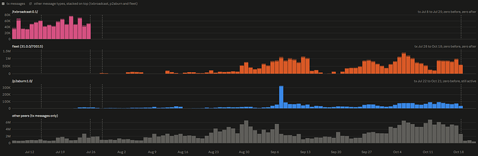

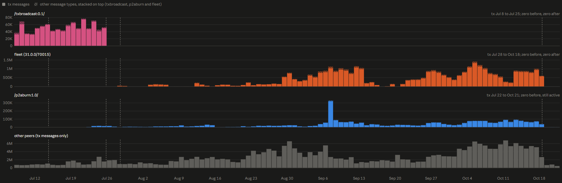

Also, see how much tx messages they were sending to my node (based on logs, until 2026-07-08):
Differences in behavior
For this specific section, most part of it was written by a llm checking my data/logs, it seems to make sense with all the data I’ve seen.
The “fleet” (builds the chains)
  • It pushes transactions without announcing them. We received 32.9M tx messages from it against only 1.8M inv. A normal peer announces with inv and sends the transaction only when asked. At its peak (Oct 5) it sent ~1.33M transactions a day.
  • It reconnects constantly. We saw ~31.7k handshakes over the period.
  • It builds P2A chains carrying Runes:
    • A root transaction, funded by a wallet input, creates an anchor (290 sats in the chain we followed; other roots use 280, 350 and so on).
    • Each link spends the previous anchor, pays 10 sats of fee and creates an anchor 10 sats smaller.
    • When the anchor reaches 240 sats (the dust limit), a refill transaction tops it up again.
    • A closing transaction pays 679 sats of fee and ends the chain.
    • Each link mints 1 unit of rune 1:0. Under the mint rule, the runes accumulate on the anchor until the closing transaction.
p2aburn (breaks the chains)
  • It says the bare minimum. We received only tx (2.96M), pong, version and verack from it. It never sends inv, ping, addr or headers, so it does not announce anything either: it just pushes transactions.
  • It reconnects a lot. We saw 28,770 handshakes, close to 3k a day at the peak (Oct 17).
  • It sweeps anchors. Each of its transactions spends an anchor in the middle of a fleet chain and turns the anchor’s whole value into fee. The verified example is sweeper 0b88a628...: 66 vB, 290 sats of fee, and it replaced links 1 to 4 in our mempool. Its average transaction size, ~66 to 80 bytes, fits this. Under the Runes mint rule, a sweep would also burn the runes accumulated on the anchor. That part is inferred: we never decoded a sweeper.
  • It was already sending transactions on Jul 22, a week before the fleet showed up. We don’t know what it was sweeping then.
  • It almost stopped after Oct 18. The following days saw ~150 transactions and ~40 connections a day, against 69k transactions on Oct 17. That fits: it ran out of chains to sweep.

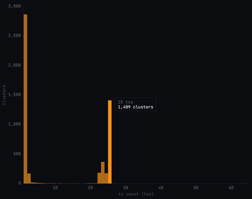

The chains are up to 25 links long. Since there is no key, the fleet can build and broadcast whole chains very fast. The flip side is that the same property lets anyone spend an anchor in the middle of a chain.
Those 25 txs clusters are very common to be in mempool, take a look at the below metric taken out of Cluster Mempool Observer histogram. Btw it’s a personal project to track a history of every movement of the mempool and its clusters (still experimental). Here you can look at many examples of them individually, and here you can see them in mempool space.
Also those “Rune mint chains” possibility is mentioned at delving#1052.

Although this post focus on this hypothesis about P2A and sweepers, feel free to comment about other theories. The focus is on why do we see this reconstruction degradation on the network.

I had some peer-observer archives from Aug 12 and Aug 18–19, so I went looking for the fleet and decoded the txs it pushed to us. They look exactly like the P2A chains described above!
The fleet showed up as /Sat0shi:31.0.0/, always inbound. It sent around 3.4k tx and only ~130 inv, and it never requested anything back. Every tx carries a runestone. Almost all of them are 25-long chains:
  • a root tx with a ~474 sat P2A output
  • 24 links, each spending the previous anchor and paying 10–11 sats of fee (~0.1 sat/vB)
  • a tail tx paying ~13 sat/vB, which pulls the whole chain in with CPFP
On Aug 12 we also had mempool events, and I could see the sweeps happening. They’re 66 vB txs that pay exactly the anchor’s 474 sats as fee, and each one evicted up to 17 links. On the same day, a good chunk of the fleet’s txs were mined, others were replaced, and a few hundred were rejected for missing inputs.
p2aburn did connect to this node, but it never sent a tx. It only did handshakes, so the sweeps reached us through other peers.

I cross-checked against our cmpctblock / getblocktxn
  • Only 5 of 162 compact blocks were reconstructed without a round trip.
  • About 96% of the txs we had to request were fleet chain links, and another 2–4% were sweeps. In 53 blocks, nothing else was missing. The worst block, 963060, needed 4,757 of its 7,049 txs, and 4,715 of those were fleet
  • Without the fleet and sweep misses, 36% of these blocks would have reconstructed with no round trip at all (vs 3% actually), and 54% would have been missing at most one other tx.
  • Most of the missing links had already reached us before the block, relayed by normal peers. We had rejected them with bad-txns-inputs-missingorspent (~87% on Aug 12) because their anchor input was gone or already spent in our mempool. The mined sweeps had been rejected for insufficient fee.

Extra: P2A had a great increase in “Input Types by Count” since 2026-07-01 until 2026-10-18, which fits our observations. See Input Types by Count, in 1d moving average you can see the start and end of it.
Thank you all for the investigation! I posted my current understanding of it to Stats on compact block reconstructions - #62 - Protocol Design - Delving Bitcoin. I think this is mostly solved for now but feel free to continue the discussion.
Oh nice spot. I think SecPool, Luxor, along with Poolin, Binance Pool, BTC.com, … don’t create a template with a Bitcoin Core v28.0 yet. They might still be relying on v27.x or older. See also Bitcoin Core versions run by mining pools and First P2A by Pool.
