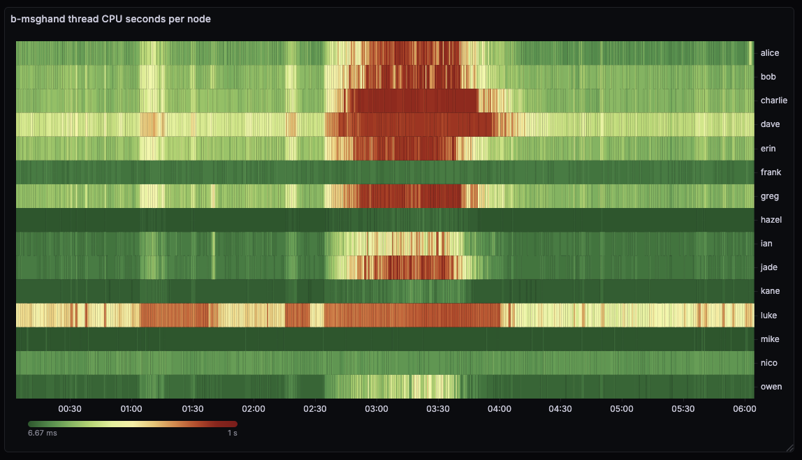

I noticed my peer-observer nodes spending a lot of time in b-msghand thread today on 2026-02-17 starting around 1:30 am UTC. Note that the screenshots are UTC+1.
(red means we spend 1000ms out of 1000ms (i.e. 100%) of our time in the thread)

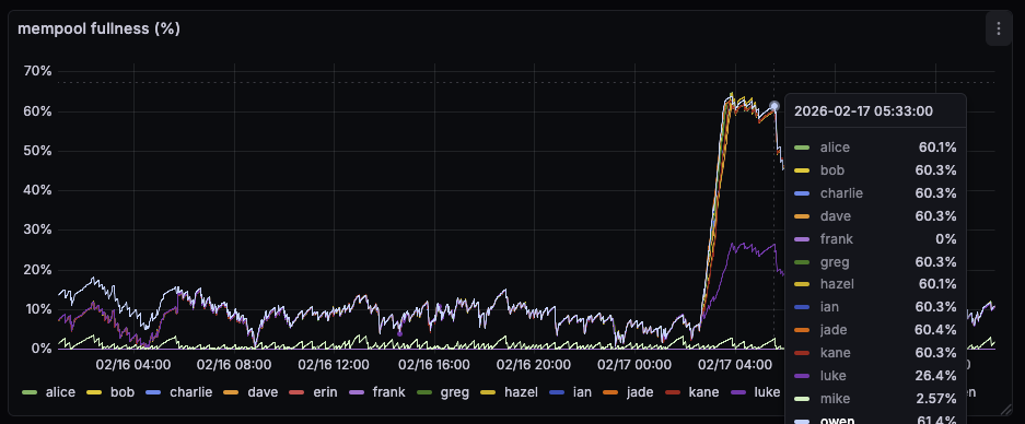

Around the same time, the mempools started to fill up from around 6% to 60%

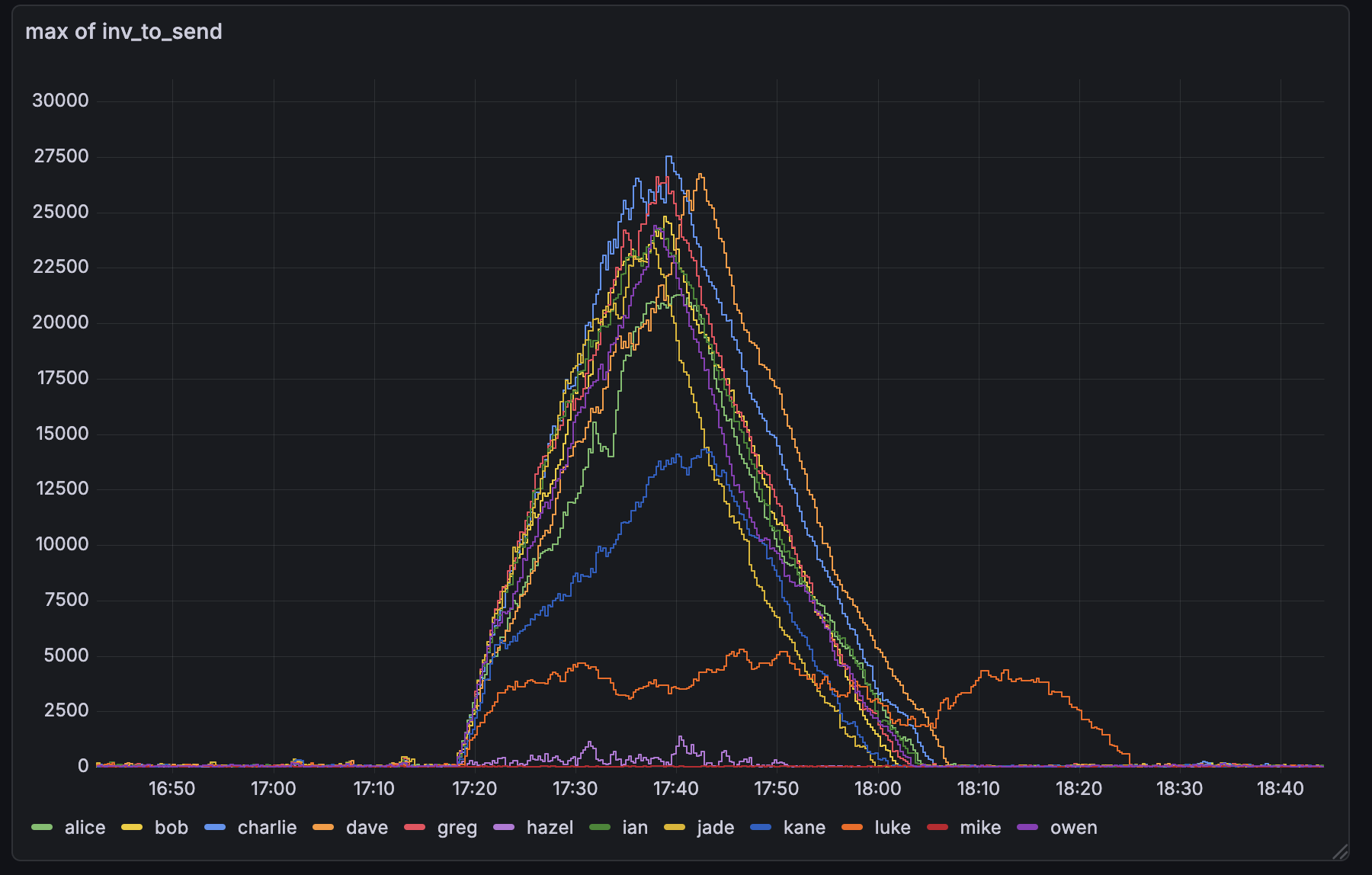

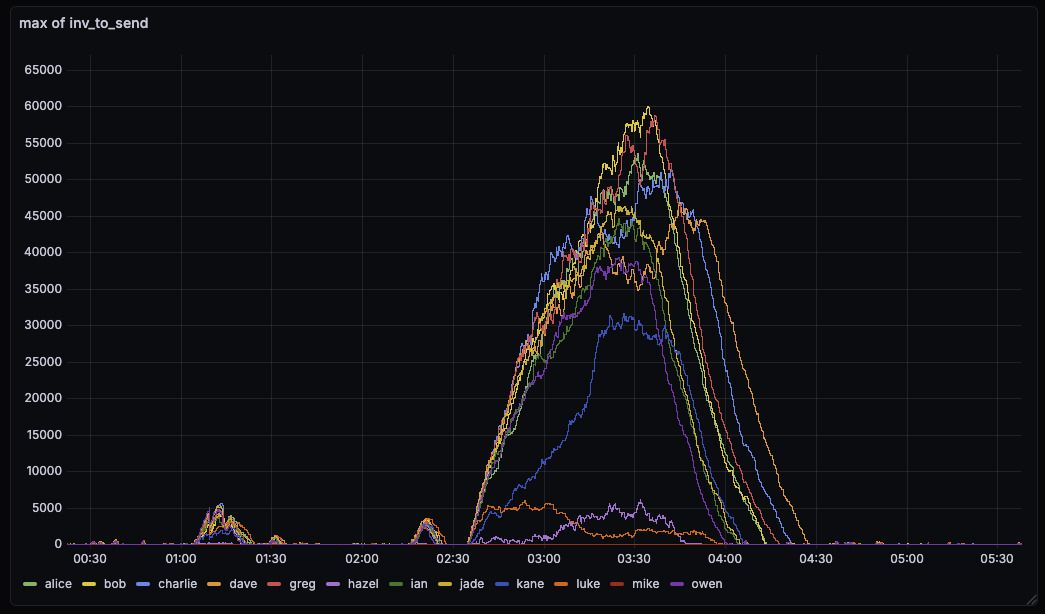

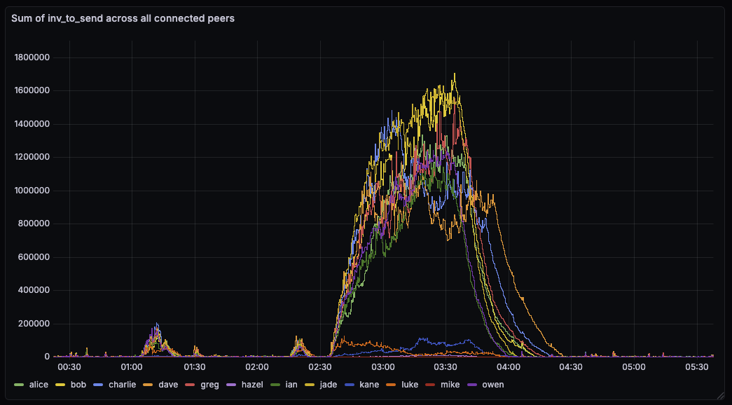

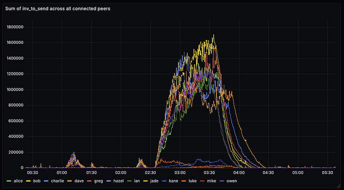

and the sum(inv-to-send) sizes across all peers increased significantly. To about 1.7 M on some nodes.
with the maxium inv-to-send sizes being about 60k

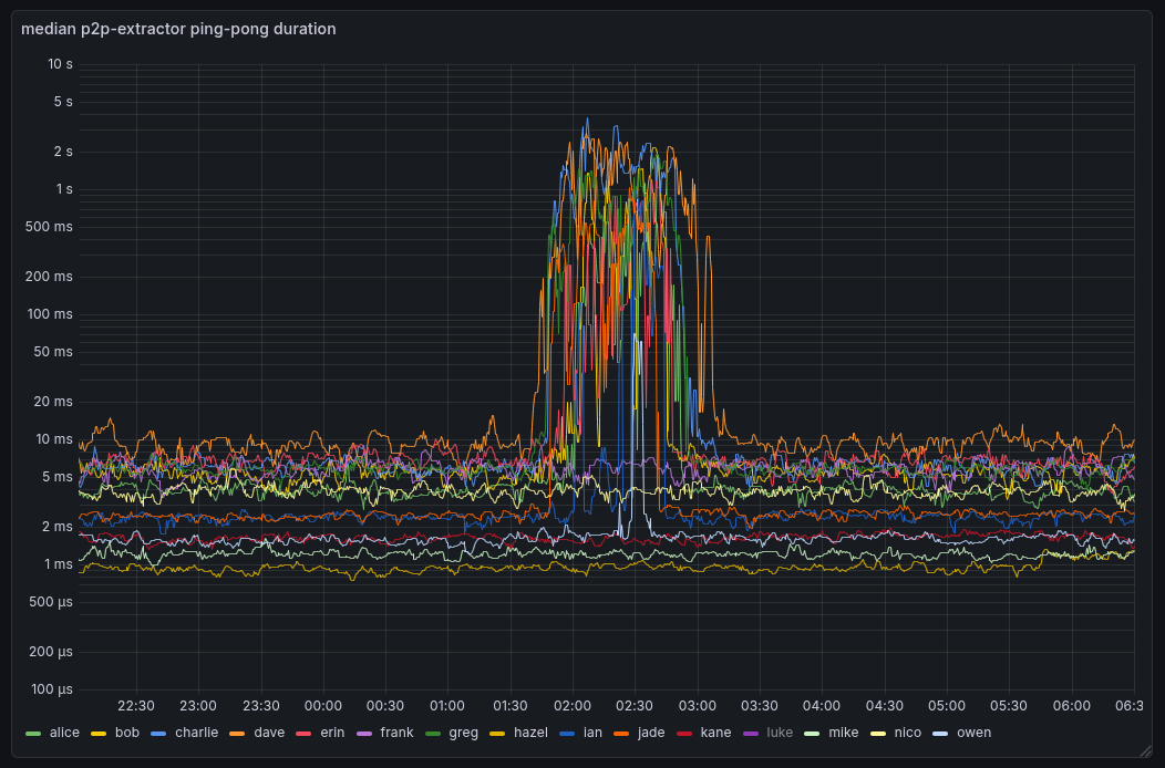

edit: It was also visible in the Bitcoin protocol Ping-Pong time monitoring I do on localhost:

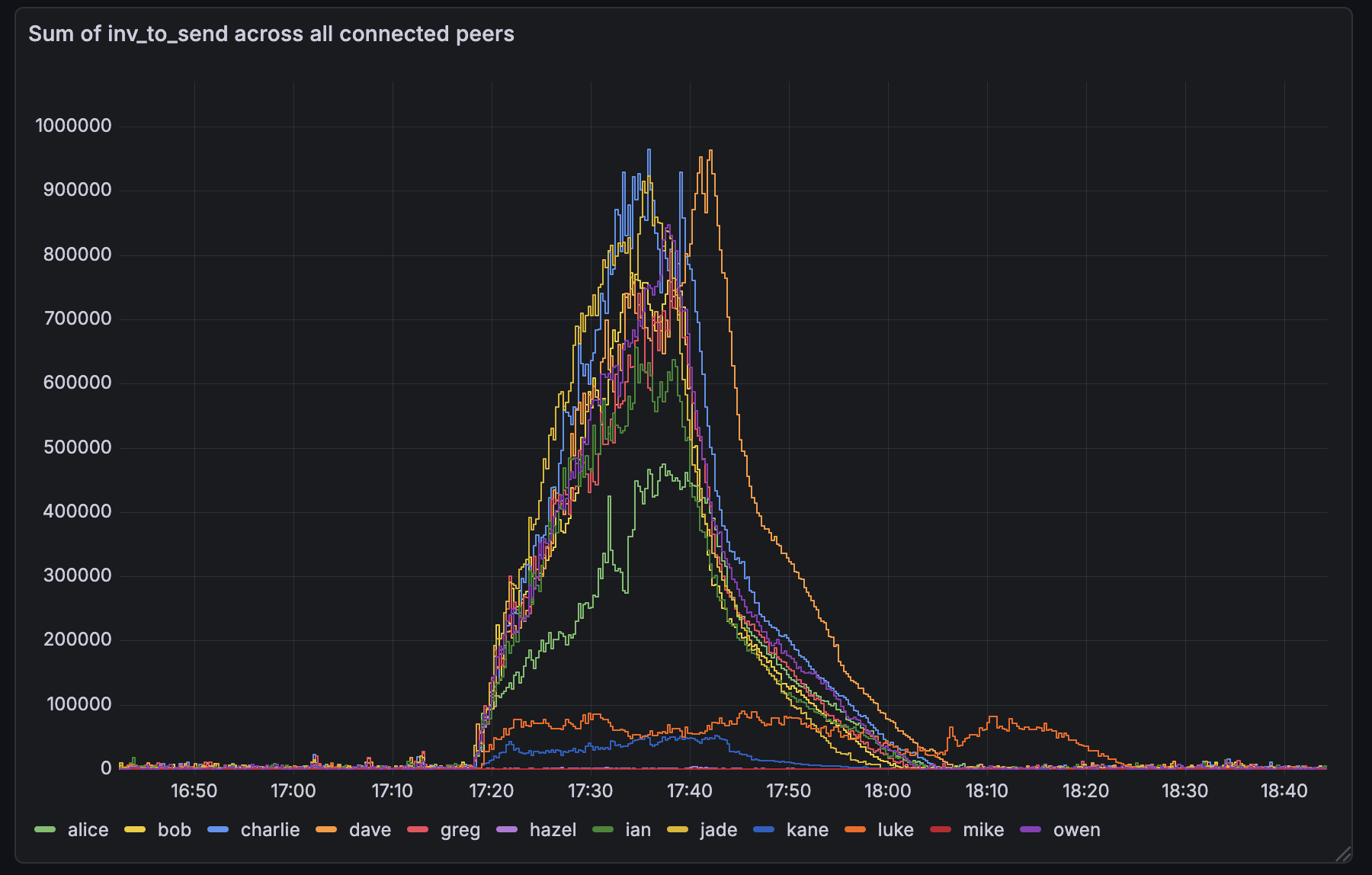

Another broadcast happend at 17:20 UTC

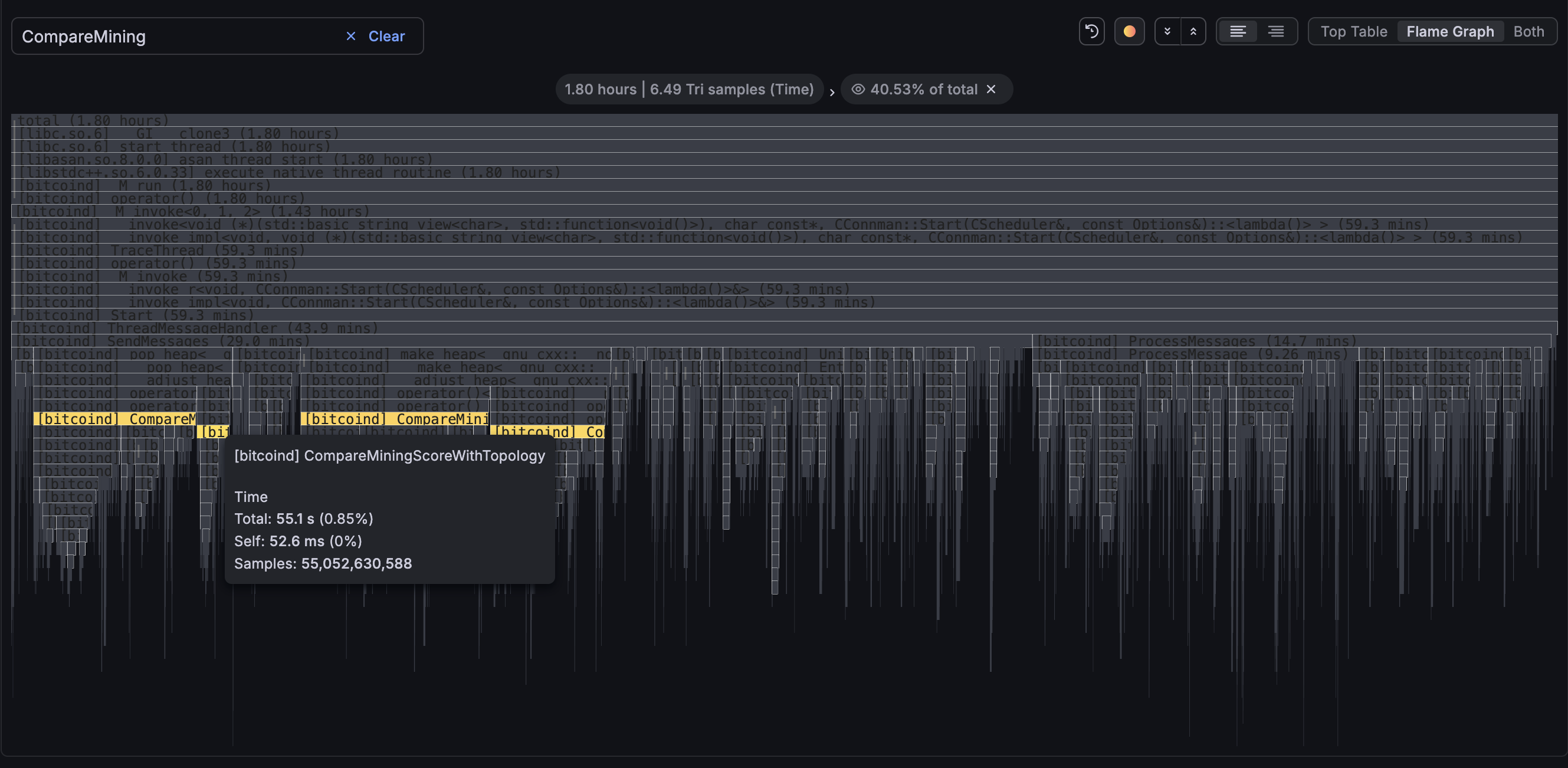

Here’s a snapshot of the continues profiling flamegraphs I’ve been experimenting with from the 1:30am broadcast: Pprof.me
It doesn’t show anything too suspicious I think. The getrawaddrman RPC taking long is known to me, but unrelated to this.
Looking on a different node at the broadcast at around 17:20 UTC shows that we spend about 20% of our time in CompareMiningScoreWithTopology() (i.e. the new name of CompareDepthAndScore).
Would one possibility be to have the inv-to-send sets always sorted from the beginning to avoid doing it every time we decide to INV something?
Sorting before sending ensures that you’re not leaking info about the order in which you received the txs by the order in which you announce them.

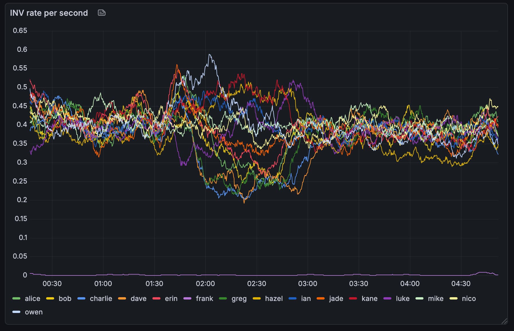

To add: here are the transaction inv-sizes to a local spy-node-like peer (does not INV any transactions to the node).
And here is the rate at which my local spy-node-like peer received WTx invs.
Normally, one would expect the rate at which we send INVs to remain fairly constant since we’re on a fixed timer. However, it seems like for some nodes it actually slowed INV-sending down by about 50% while for others it (at least briefly) speed up. My theory for slowing down is: the node is overloaded to a point where it can’t send out INVs at a normal rate.

There seems to have been a small mass-broadcast event a few hours ago. Here are some observations:
On bob, running #34628 with default txsendrate, the inv-to-send queues stayed a lot smaller. This is expected as we drain the per-peer queue immediately with 34628.
On bob, we spend a lot less time in the b-msghand thread:
And the response time for a localhost ping didn’t increase for bob, while it did for the other nodes.

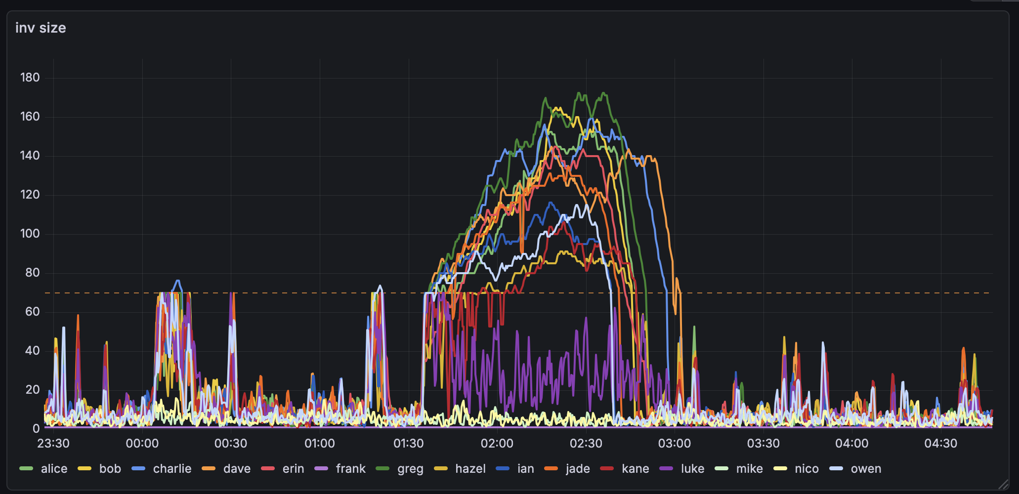

The INVs sent by bob were larger than the ones by the other nodes. With 34628, we fully drain the per-peer queue, so INVs can be larger than before, were we capped it at 70 (unless the queue got large).
Double-size INVs might not be verymeaningful – when there’s a backlog with #34628 the timing can be out of sync, acting like “send-inv, send-inv, populate-inv-queue, populate-inv-queue, send-inv”, so that the second send-inv is empty, and the third send-inv has to tranches of txs. Because populate-inv-queue targets a particular tx rate, send-inv over time should still average to the same 70tx-per-send-inv rate, even though individual send-inv’s can be two (or more) times that.

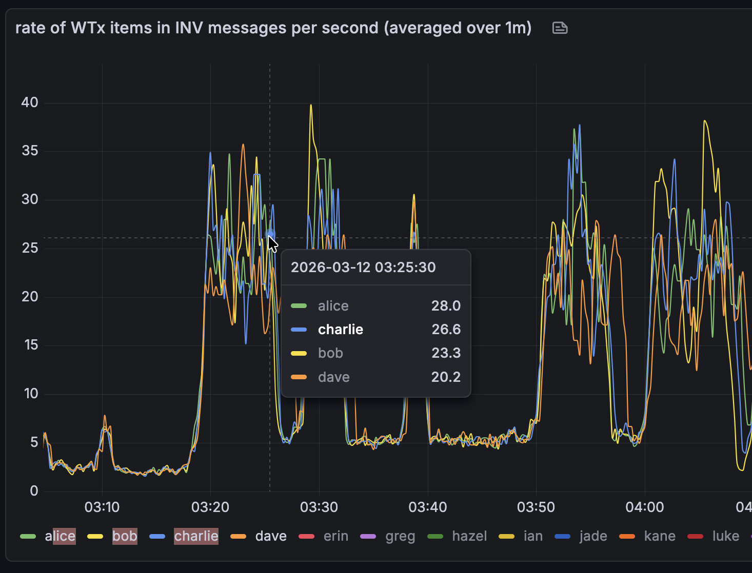

Are you able to do a rolling-average over 30s or 60s for that graph by any chance? I think that should bring the outgoing inv rates in line with each other.

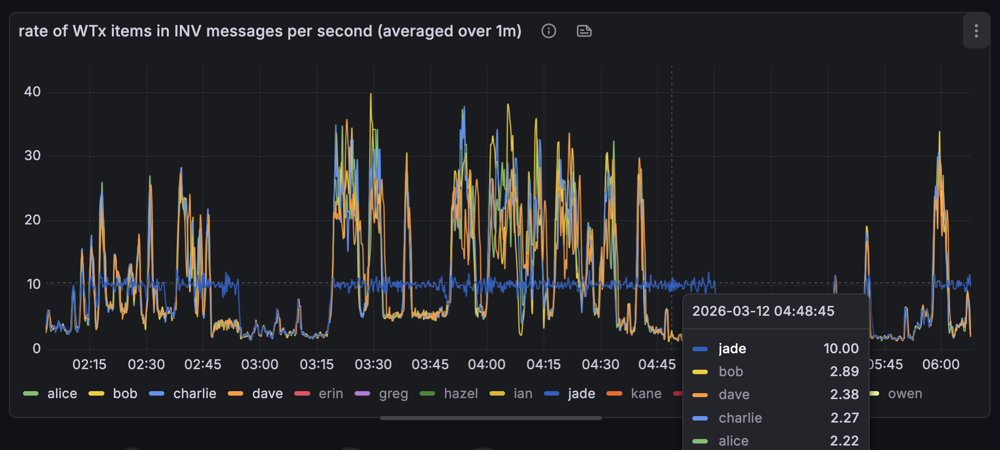

I have “number of WTx entries send per second, averaged over 60s”. Note that these are to an -addnode peer (outbound), so we send INVs every two seconds.
Node jade also runs the patch and is using the new -txsendrate=4 arg. During the mass broadcast, we see it announcing 10 transactions per second to the outbound addnode peer. -txsendrate is configuring the relay rate to inbound connections. As we relay to oubounds at 2.5x the rate, we’d expect 2.5 * 4 = 10, which exactly matches our expectation.
It’s visible that node jade takes a lot longer than the other nodes to process the annoucements.
Is jade also avoiding high b-msghand thread time? If so, it’s behaving as expected: 4tx/s is too slow for mainnet for inbound connections (5000tx/block is about 8 tx/s), so it’s mostly a good way of observing the backlog behaviour, rather than something sensible to run.
The ‘rate of WTx over 60s’ graph looks good to me. Interesting that the floor rose (~2tx/s between 3:10 and 3:20 vs 5tx/s between 3:40 and 3:50).
yes! Though jade also has a stronger and different CPU that the others, so the numbers aren’t directly comparable.

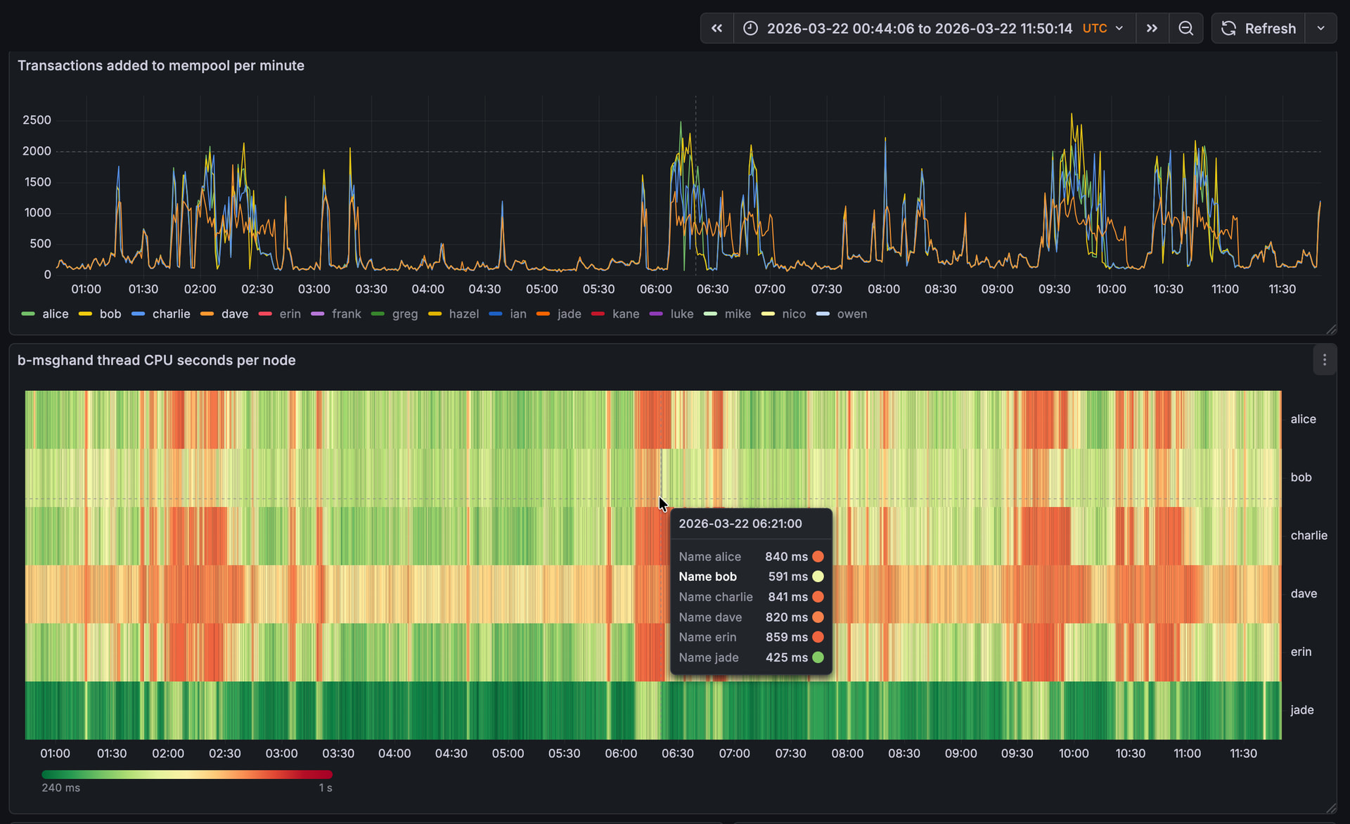

Looking at a recent event, now that the inbound slots on bob have filled up fully, it’s visible that the time we spend in b-msghand is mostly transaction validation, but not transaction propagation anymore. On the other nodes, we have a higher b-msghand utilization for longer, as we first do transaction validation and then the expensive transaction propagation.
