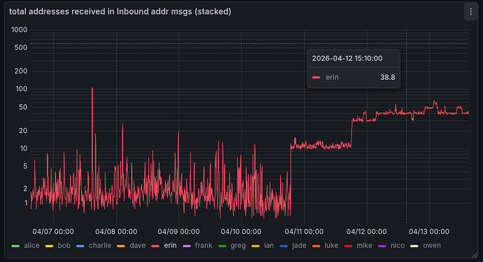

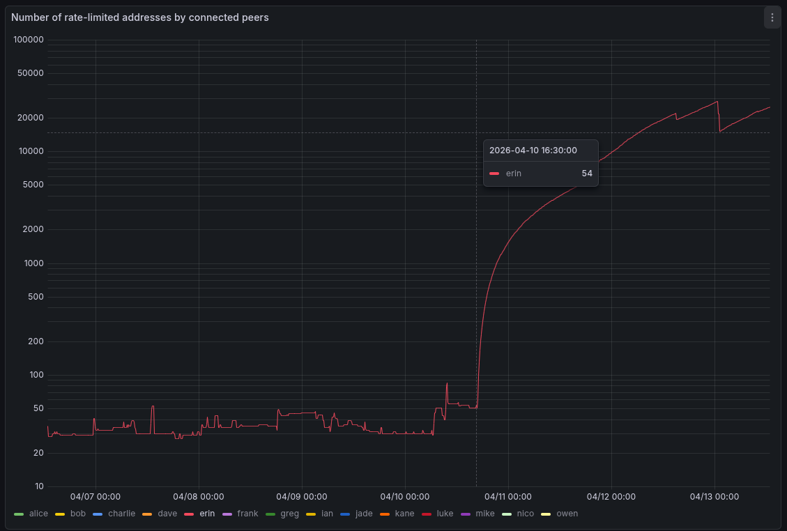

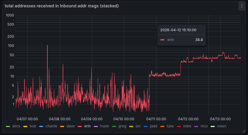

Since 2026-04-10 at about 16:30 UTC I’ve seen multiple IPv4 addresses connect to my monitoring nodes gossiping addresses via addr (and not addrv2) at a higher rate. These addresses are frequently rate-limited.
IPs are:
My node erin is receiving about 40 addresses per minute now.

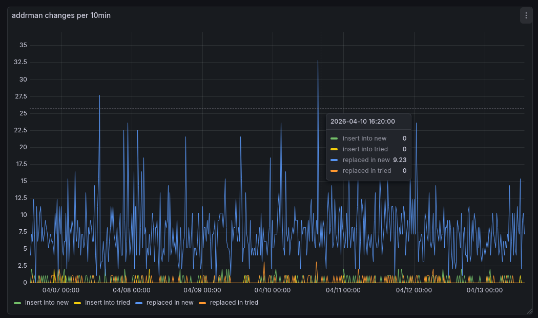

Looking at the addrman of erin, the seems to be only the normal background noise of additions and replacements in the new and tried table:

    "addr_relay_enabled": true,
    "addr_processed": 24650,
    "addr_rate_limited": 14316,

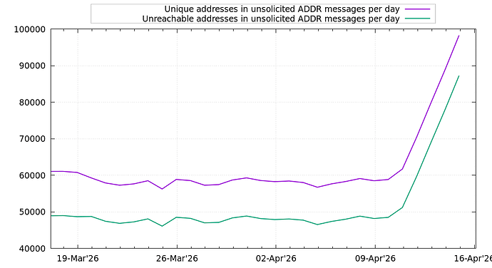

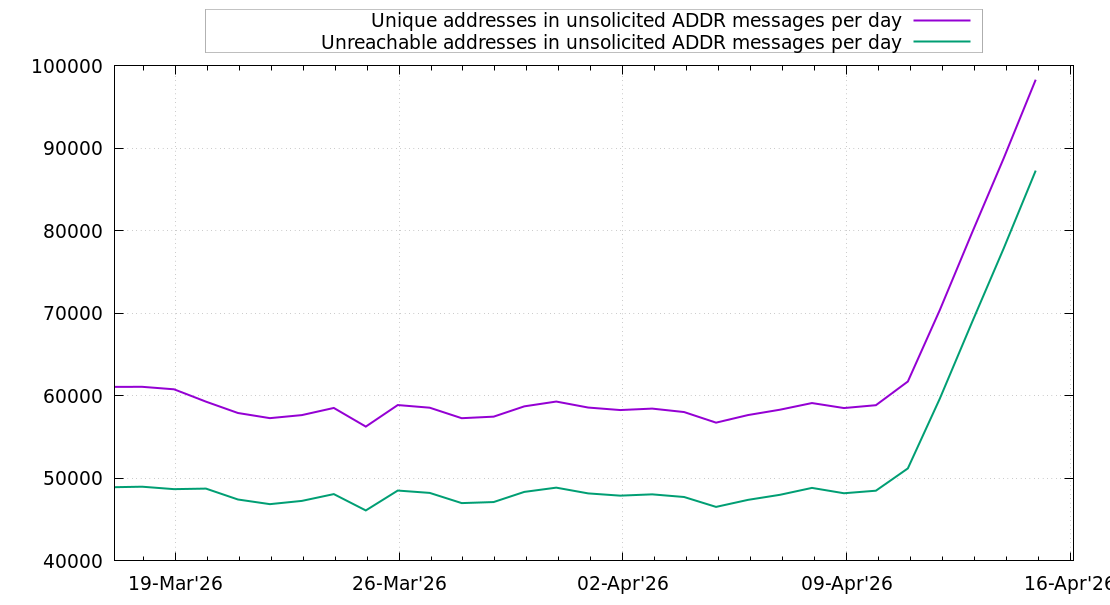

In our monitoring, we see that the number of unique addresses being propagated in the network has risen noticeably during the last days:
This effect is probably caused by the peers that are described above in this topic.
The observation indicates that the newly propagated addresses are unreachable and have not previously been announced in the network. Without having looked further into the set of distributed addresses I suppose that they might have been randomly generated.

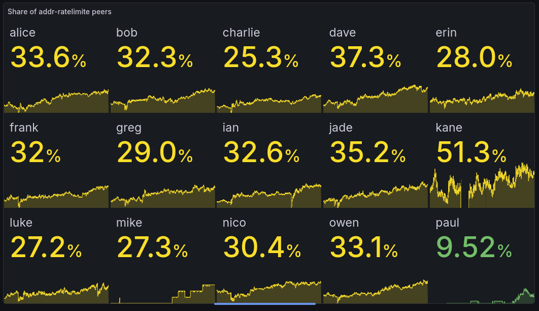

Fwiw this is still ongoing. I’m seeing ~30% of my peers having at least gotten one address rate-limited now.
